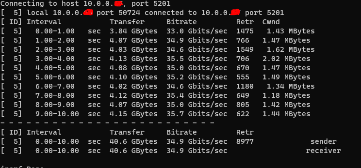

I recently build a new NAS system with Truenas on it. It has quite good specs: dual 10 core intel xeon 2690v3, 128gb RAM, and a Mellanox Connect-x4 dual 100gbit/s card. I have 2 pools in the system. one consists of 16 2tb WD RED SA500 SSDs and it is a mirrored pool 8 x MIRROR | 16 wide. I have another Server (in the following called client) with the same Mellanox card and they are both connected to a Mikrotik switch via a 40gb link. I have tested the Fiber link between the servers with iperf and it is (almost)40gbit. see picture below
I have run this iperf test a few times and always get the same result within a little variation.

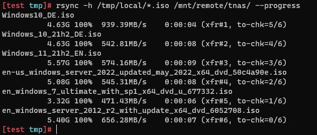

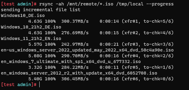

When I then Try to create a NFS share on the Truenas and mount it on the second Server (which I will Client with the 40bg link) and copy some isos between them I only get around 300mb/s of transfer speed from the Truenas to the Client.
When doing it the other way around (Client to Server) it is a little faster and I get around 500-600mb/s
