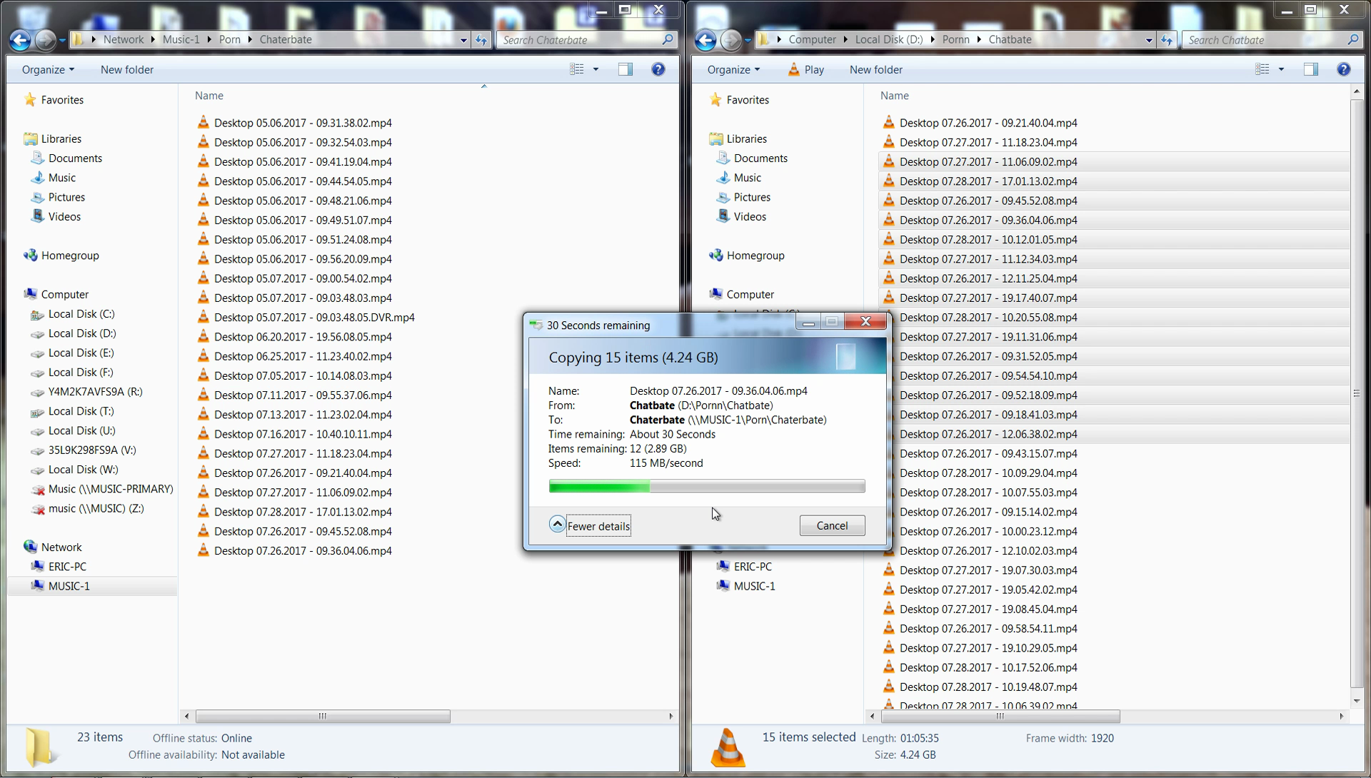

So I finally got my lazy ass around to doing a clean install and everything seems to be working fine now. I copied over some files and it started at about 115MB/s and then fell to 104-106MB/s for most of the transfer and then started to decline to 86.7MB/s by the end. It is much better than before but it seems FreeNAS has a hard time keeping it up. ;) It would be nice if it could consistently saturate my connection.
I just ordered a 40Gbe switch and got some of the Mellanox ConnectX-2 10Gbe cards and I may get two of the X-3 40Gbe cards. So I will see soon enough if FreeNAS can saturate faster connections.
