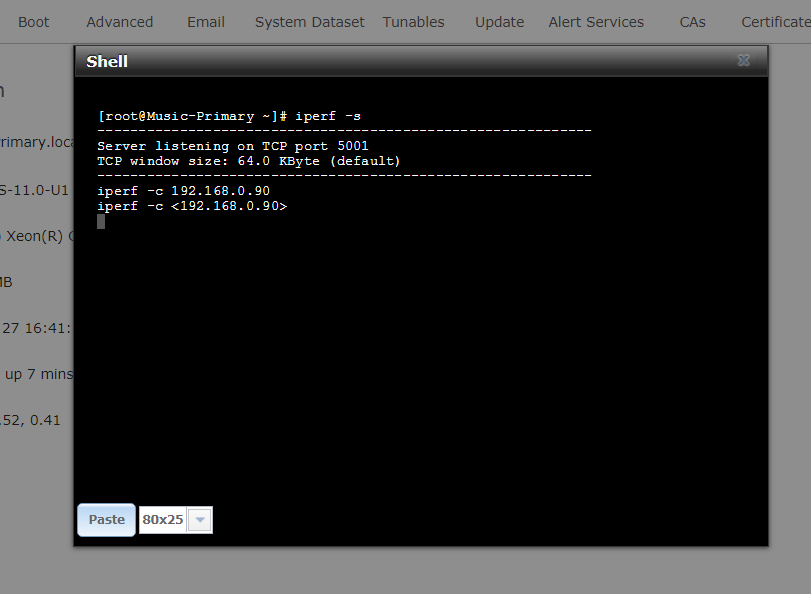

I don't understand. I used the iperf client linked to in the guide and that was apparently not good enough so I don't get it...

So you have some Network bottleneck. How does your network layout look like? Switch, Ethernet cables, client specs? Can you direct connect your two systems. No switch and a single Ethernet cable.

Then your client has a terrible network card. Can you run the iperf test going the other direction?
Can you clarify this? Do you want to to connect my server directly to my PC and run the test? I can't see how that would give me different results considering my transfer speed is the same either way.

I want you to try and connect your server directly to FreeNAS. Then run iperf as the server on bother FreeNAS and your Windows client. So you can test both ways.

I have a hard time understanding what you are saying. Ignoring the grammatical mistakes in your responses, You need to explain what you want me to do in a step by step way as if I am an idiot which I am when it comes to Linux, BSD and CLI's.
In any case, I ran another test and have thus proven that these issues are without a doubt the fault of FreeNAS and not my server or network hardware.
What I did was...
I swapped out the OS drive that has FreeNAS on it for another that has OpenMediaVault installed on it. Imported my pool and created an SMB share and copied some files over to my server. I was getting sustained speeds of 110-115MB/s transfer speed which is a lot better than the 30MB/s I was getting from FreeNAS.
So now that we know FreeNAS is the issue, how do we solve it?
