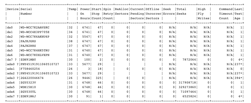

Not sure if this was mentioned already, but I'm noticing a "?" next to the drive name. What does it mean?
joeschmuck
Old Man
May 28, 2011
10,996

thepixelgeek
Jan 21, 2016
271
@joeschmuck Looking for notes, using Spearfoot's script. Perhaps I've had too much to drink, but don't see any.
Edit: I do see warnSymbol="?" in the script, but not the explanation.
thepixelgeek
Jan 21, 2016
271
Perhaps it's due to the astresk on test age? See below image. Ada7 and da7 are brand new drives recently resilvered. Ada2 and 0 are SSD's not being used. Ada3 (SSD) is a boot drive.
joeschmuck
Old Man
May 28, 2011
10,996
LOL, perhaps, I might have forgot that not everyone can interpret scripts, I'm still learning with the odd nuances between BSD, Linux, and all the variants in between.
So if you take a look at the script (it's almost in English), line 19 defines the "?" as the Warning Symbol. Line 18 defines the Test Age Warning to be greater than 1 day (you need to read more of the code to determine that and it actually decodes to a SMART Short or Long test has passed within the last 24 hours (testAgeWarn * 24) at the time this script is run.) And as you ascertained the "*" asterisks identify the alarm indication which in this case are also provided as days since that last SMART Test was run to pass. Keep in mind that you are being alerted to a Warning, not a failure in this case.
If you go and look at the SMART data to each drive (should be in the automated email) then you can see what SMART is reporting for the drives. You may not have a test scheduled for all the drives even though you might think you do. Double check it.
You can change the script if you desire to change the testAgeWarn=7 or some other value if you like. Make the script work for you. This is the same for sectorsCrit=10, I have my setting at 1 because if there is a single failure, I want to know about it right away. Same thing for the drive temperatures.
So while I didn't have too much to drink tonight, I am tired and can barely see through my eyes. Got up very early to send my daughter on the road headed back home. If you have any questions about the script, ask. I'm not online every day but someone will answer or I will eventually get back to you.
Also, all your drive temps look great, all the other values look good too, except for the SMART test ages for the few drives indicating a warning.
Spearfoot
He of the long foot
May 13, 2015
2,478
You're correct -- the script is warning you that the indicated disks have not been tested recently.

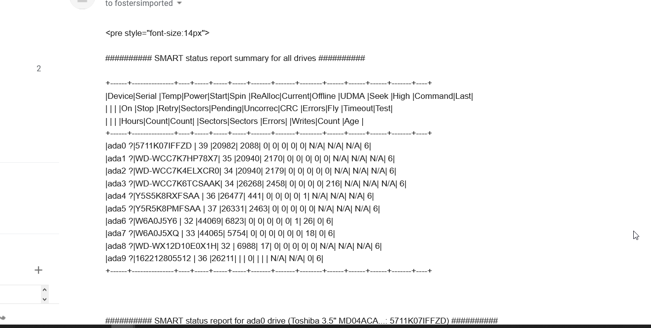

fostersimported
Jul 25, 2011
19
I have the smart script working, but cannot work out why the table is not formating in my e-mail. Can anyone help?
This is my email.
When I check the tmp file the script creates it is formatted in a table.
Cheers
Spearfoot
He of the long foot
May 13, 2015
2,478
This is my email.
Cheers
You're running an older version of the script. I had to add proper MIME encoding to make it work better with recent versions of FreeNAS/TrueNAS. You can download the latest version here: https://github.com/Spearfoot/FreeNAS-scripts

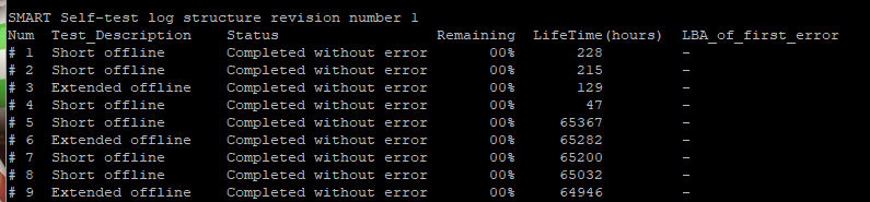

Sjöhaga
Apr 17, 2016
41

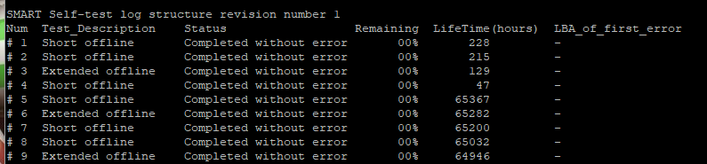

Today I thought I hade broken the script but after some research I realised it wasn't my fault but rather WD.
The script reported a very high 'Last Test Age'.
Turns out the smart log rolls over at 65k hours for the old WD Red WD40EFRX drives :smile:.
Spearfoot
He of the long foot
May 13, 2015
2,478
Yep, looks like Western Digital used a 2-byte unsigned integer to store the power-on hours, and it wrapped after 65535 hours. That's pretty good service from a 'Red' disk!

POH is keeping up in attributes data, but not in the smart log, so the test age division gets funky :smile: .
But I think this is one of those bugs we don't really need to fix :grin:.
POH keep increasing in the attributes data so it's not completely broken.
And now I know I can't replace those drives. I want to know how long they will last :D. 2014 wan't that long ago, was it...
