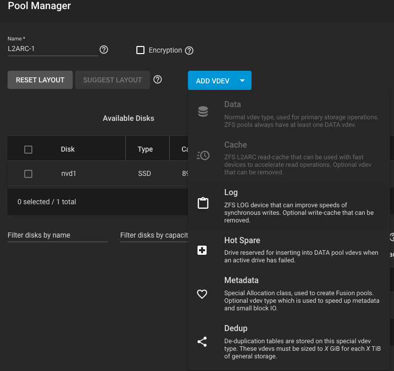

So as you posted, you accidentally created a second pool (L2ARC-01) rather than adding it as a vdev of type cache to your main pool (WolfTruePool) - you'll want to export and destroy the second pool (L2ARC-01) and then extend/Add Vdevs on the main pool (WolfTruePool) and use it as type cache.
The command is correct - it just doesn't produce any output if successful. It's also case-sensitive as shown below, so you'll need to match whatever your pool and dataset/volume name are.
Ok, Destroyed... But i thought I HAD done the creation as a cache type... It said so as "Cache L2ARK" type and I selected as such. How did it manage to be a mistake?
As that's the type being displayed to me, I have to say I'm stuck; that's the choice I have. See Below:
That's the same thing I choose last time. So I'm doing something wrong but I'm not sure what.
You're clicking the big button "ADD", which adds a pool.
Click the gear icon and select "Add Vdevs" to add a cache vdev to WolfTruePool.

What is your zpool status output?
Data Below. I'm going to try the other way to build the dev needed:

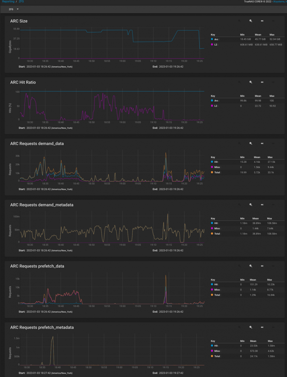

Completed. The writes have been ghastly after the first 5-7gigs throughput. Then the system strangles itself from 300MiB over a 2.5 connection and drops to half a meg a second.
I have a few more scans below..

I've completed the tunable. Im debating rebooting to see if that changes times to online or just awaiting results.
Do tunables take effect immediately? Or only after reboot?
HoneyBadger
actually does care
Administrator
Feb 6, 2014
5,112
Certain tunables are immediate; arc_meta_min should be as well, but ZFS still needs to read your deduplication tables from disk at least once to get them back into RAM.
Does your arc_summary output now show a higher value for "Metadata cache size (current)" if you run it again?

root@truenas[~]# arc_summary
(Part 1)
ZFS Subsystem Report                            Tue Jan 03 18:50:58 2023
FreeBSD 13.1-RELEASE-p2                                    zpl version 5
Machine: truenas.local (amd64)                          spa version 5000
ARC status:                                                      HEALTHY
        Memory throttle count:                                         0
ARC size (current):                                    83.6 %   48.0 GiB
        Target size (adaptive):                        90.3 %   51.9 GiB
        Min size (hard limit):                          3.5 %    2.0 GiB
        Max size (high water):                           28:1   57.5 GiB
        Most Frequently Used (MFU) cache size:         28.6 %   13.2 GiB
        Most Recently Used (MRU) cache size:           71.4 %   32.9 GiB
        Metadata cache size (hard limit):              75.0 %   43.1 GiB
        Metadata cache size (current):                  7.2 %    3.1 GiB
        Dnode cache size (hard limit):                 37.1 %   16.0 GiB
        Dnode cache size (current):                     5.8 %  948.3 MiB
ARC hash breakdown:
        Elements max:                                               1.8M
        Elements current:                              77.1 %       1.4M
        Collisions:                                                 1.1M
        Chain max:                                                     5
        Chains:                                                   104.4k
ARC misc:
        Deleted:                                                   11.1M
        Mutex misses:                                                284
        Eviction skips:                                             1.5M
        Eviction skips due to L2 writes:                               0
        L2 cached evictions:                                     3.0 GiB
        L2 eligible evictions:                                  16.3 GiB
        L2 eligible MFU evictions:                     14.1 %    2.3 GiB
        L2 eligible MRU evictions:                     85.9 %   14.0 GiB
        L2 ineligible evictions:                                 1.3 TiB
ARC total accesses (hits + misses):                                11.9G
        Cache hit ratio:                              100.0 %      11.9G
        Cache miss ratio:                             < 0.1 %       2.6M
        Actual hit ratio (MFU + MRU hits):            100.0 %      11.9G
        Data demand efficiency:                        81.1 %       6.1M
        Data prefetch efficiency:                       2.8 %     616.8k
Cache hits by cache type:
        Most frequently used (MFU):                    99.8 %      11.8G
        Most recently used (MRU):                       0.1 %      17.7M
        Most frequently used (MFU) ghost:             < 0.1 %     225.3k
        Most recently used (MRU) ghost:               < 0.1 %      57.6k
        Anonymously used:                             < 0.1 %     161.3k
Cache hits by data type:
        Demand data:                                  < 0.1 %       5.0M
        Demand prefetch data:                         < 0.1 %      17.2k
        Demand metadata:                               99.9 %      11.8G
        Demand prefetch metadata:                       0.1 %       6.0M
Cache misses by data type:
        Demand data:                                   45.0 %       1.2M
        Demand prefetch data:                          23.2 %     599.7k
        Demand metadata:                               27.1 %     699.2k
        Demand prefetch metadata:                       4.7 %     122.1k
DMU prefetch efficiency:                                            1.8M
        Hit ratio:                                     39.7 %     723.4k
        Miss ratio:                                    60.3 %       1.1M
L2ARC status:                                                    HEALTHY
        Low memory aborts:                                             0
        Free on write:                                                 0
        R/W clashes:                                                   0
        Bad checksums:                                                 0
        I/O errors:                                                    0
L2ARC size (adaptive):                                           3.7 GiB
        Compressed:                                    16.9 %  641.8 MiB
        Header size:                                    0.0 %    0 Bytes
        MFU allocated size:                            50.0 %  321.1 MiB
        MRU allocated size:                            56.4 %  362.1 MiB
        Prefetch allocated size:                        0.2 %    1.1 MiB
        Data (buffer content) allocated size:           0.0 %    0 Bytes
        Metadata (buffer content) allocated size:     106.6 %  684.2 MiB
L2ARC breakdown:                                                  134.4k
        Hit ratio:                                     11.3 %      15.2k
        Miss ratio:                                    88.7 %     119.2k
        Feeds:                                                      2.7k
L2ARC writes:
        Writes sent:                                    100 %       1.5k
L2ARC evicts:
        Lock retries:                                                  0
        Upon reading:                                                  0
Tunables:
        abd_scatter_enabled                                            1
        abd_scatter_min_size                                        4097
        allow_redacted_dataset_mount                                   0
        anon_data_esize                                                0
        anon_metadata_esize                                            0
        anon_size                                                2392576
        arc.average_blocksize                                       8192
        arc.dnode_limit                                                0
        arc.dnode_limit_percent                                       10
        arc.dnode_reduce_percent                                      10
        arc.evict_batch_limit                                         10
        arc.eviction_pct                                             200
        arc.grow_retry                                                 0
        arc.lotsfree_percent                                          10
        arc.max                                              61713000000
        arc.meta_adjust_restarts                                    4096
        arc.meta_limit                                                 0
        arc.meta_limit_percent                                        75
        arc.meta_min                                         17179869184
        arc.meta_prune                                             10000
        arc.meta_strategy                                              1
        arc.min                                                        0
        arc.min_prefetch_ms                                            0
        arc.min_prescient_prefetch_ms                                  0
        arc.p_dampener_disable                                         1
        arc.p_min_shift                                                0
        arc.pc_percent                                                 0
        arc.prune_task_threads                                         1
        arc.shrink_shift                                               0
        arc.sys_free                                                   0
        arc_free_target                                           347464
        arc_max                                              61713000000
        arc_min                                                        0
        arc_no_grow_shift                                              5
        async_block_max_blocks                      18446744073709551615
        autoimport_disable                                             1
        btree_verify_intensity                                         0
        ccw_retry_interval                                           300
        checksum_events_per_second                                    20
        commit_timeout_pct                                             5
        compressed_arc_enabled                                         1
        condense.indirect_commit_entry_delay_ms                        0
        condense.indirect_obsolete_pct                                25
        condense.indirect_vdevs_enable                                 1
        condense.max_obsolete_bytes                           1073741824
        condense.min_mapping_bytes                                131072
        condense_pct                                                 200
        crypt_sessions                                                 0
        dbgmsg_enable                                                  1
        dbgmsg_maxsize                                           4194304
        dbuf.cache_shift                                               5
        dbuf.metadata_cache_max_bytes               18446744073709551615
        dbuf.metadata_cache_shift                                      6
        dbuf_cache.hiwater_pct                                        10
        dbuf_cache.lowater_pct                                        10
        dbuf_cache.max_bytes                        18446744073709551615
        dbuf_state_index                                               0
        ddt_data_is_special                                            1
        deadman.checktime_ms                                       60000
        deadman.enabled                                                1
        deadman.failmode                                            wait
        deadman.synctime_ms                                       600000
        deadman.ziotime_ms                                        300000
        debug                                                          0
        debugflags                                                     0
        dedup.prefetch                                                 0
        default_bs                                                     9
        default_ibs                                                   15
        delay_min_dirty_percent                                       60
        delay_scale                                               500000
        dirty_data_max                                        4294967296
        dirty_data_max_max                                    4294967296
        dirty_data_max_max_percent                                    25
        dirty_data_max_percent                                        10
        dirty_data_sync_percent                                       20
        disable_ivset_guid_check                                       0
        dmu_object_alloc_chunk_shift                                   7
        dmu_offset_next_sync                                           1
        dmu_prefetch_max                                       134217728
        dtl_sm_blksz                                                4096
        embedded_slog_min_ms                                          64
        flags                                                          0
        fletcher_4_impl [fastest] scalar superscalar superscalar4 sse2 ssse3 avx2
        free_bpobj_enabled                                             1
        free_leak_on_eio                                               0
        free_min_time_ms                                            1000
        history_output_max                                       1048576
        immediate_write_sz                                         32768
        initialize_chunk_size                                    1048576
        initialize_value                            16045690984833335022
        keep_log_spacemaps_at_export                                   0
        l2arc.exclude_special                                          0
        l2arc.feed_again                                               1
        l2arc.feed_min_ms                                            200
        l2arc.feed_secs                                                1
        l2arc.headroom                                                 2
        l2arc.headroom_boost                                         200
        l2arc.meta_percent                                            33
        l2arc.mfuonly                                                  0
        l2arc.noprefetch                                               0
        l2arc.norw                                                     0
        l2arc.rebuild_blocks_min_l2size                       1073741824
        l2arc.rebuild_enabled                                          1
        l2arc.trim_ahead                                               0
        l2arc.write_boost                                       40000000
        l2arc.write_max                                         10000000
        l2arc_feed_again                                               1
        l2arc_feed_min_ms                                            200
        l2arc_feed_secs                                                1
        l2arc_headroom                                                 2
        l2arc_noprefetch                                               0
        l2arc_norw                                                     0
        l2arc_write_boost                                       40000000
        l2arc_write_max                                         10000000
        l2c_only_size                                                  0
        livelist.condense.new_alloc                                    0
        livelist.condense.sync_cancel                                  0
        livelist.condense.sync_pause                                   0
        livelist.condense.zthr_cancel                                  0
        livelist.condense.zthr_pause                                   0
        livelist.max_entries                                      500000
        livelist.min_percent_shared                                   75
        lua.max_instrlimit                                     100000000
        lua.max_memlimit                                       104857600
        max_async_dedup_frees                                     100000
        max_auto_ashift                                               14
        max_dataset_nesting                                           50
        max_log_walking                                                5
        max_logsm_summary_length                                      10
        max_missing_tvds                                               0
        max_missing_tvds_cachefile                                     2
        max_missing_tvds_scan                                          0
        max_nvlist_src_size                                            0
        max_recordsize                                           1048576
        metaslab.aliquot                                         1048576
        metaslab.bias_enabled                                          1

If you go to the reporting section of the GUI then ZFS you have the graphs about arch. Taking a look there might help you understand better.
Cache also needs time to grow.
I suppose that section is for metadata vdevs but... calling them cache it strange to me.
Im' not blowing wind up your skirt, but if *you* don't know, I have no chance.
But I do see it now..
Here's the screenshot that I'm going to shrink to fit here.
It's grown a few more entries than the last time I remember looking at it.

All in all, the system is working far better than it did..it's not perfect, and uploads to it pulse from 250MB/sec down to 150ish, but it's far better than it was. Honestly, the Ryzen 5600X is kinda loafing so it seems odd to me that there are such variations in i/o. More to learn :)
