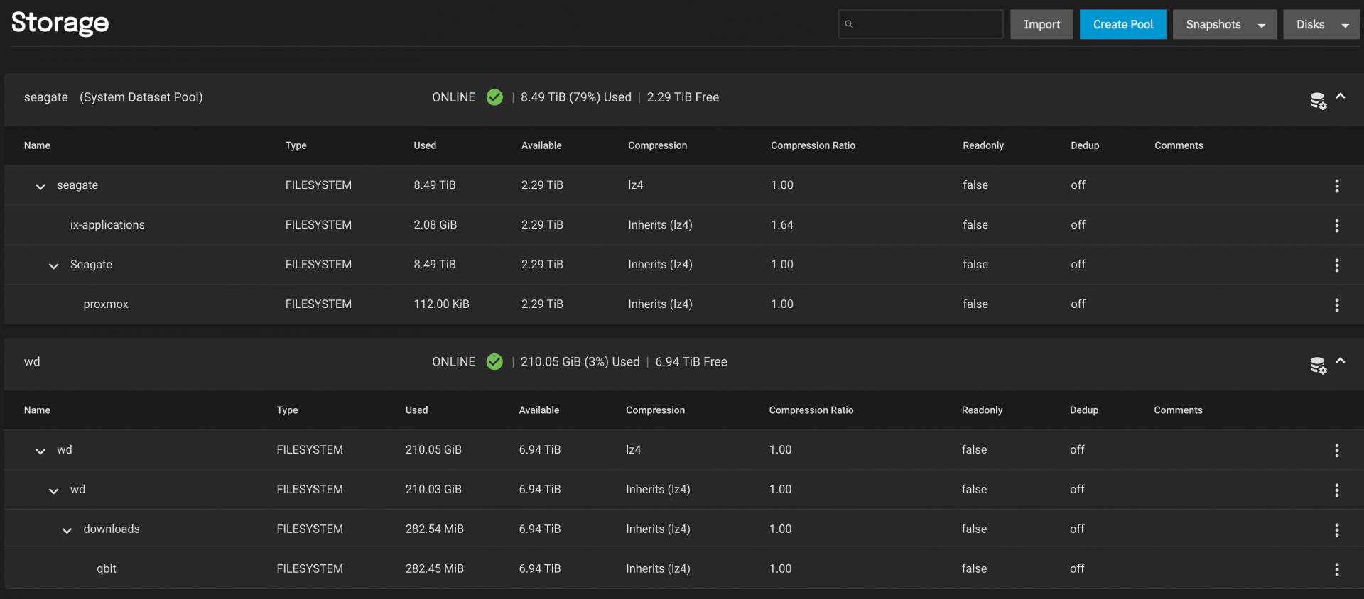

Hi Elliot, thanks for the answer i added my truenas specs as signature and here are my 2 pools below
and sorry i dont know what fio is

8G of RAM? That is well below the minimum supported is not 16G if I recall correctly. I suspect that the number of disks (more vdevs = more throughput) is hurting you, but primarily the lack of RAM is hurting your reads. My main pool has 8 mirror vdevs (see signature) and 256G of RAM. That allows me to get the 13 gigabit sustained read (40 gigabit storage network) with bursts above 16. Writing is 4-5gb with an NVMe SLOG. Your first need is more RAM. Then look at more vdevs if you case can support it. That is where you will get better I/O.
