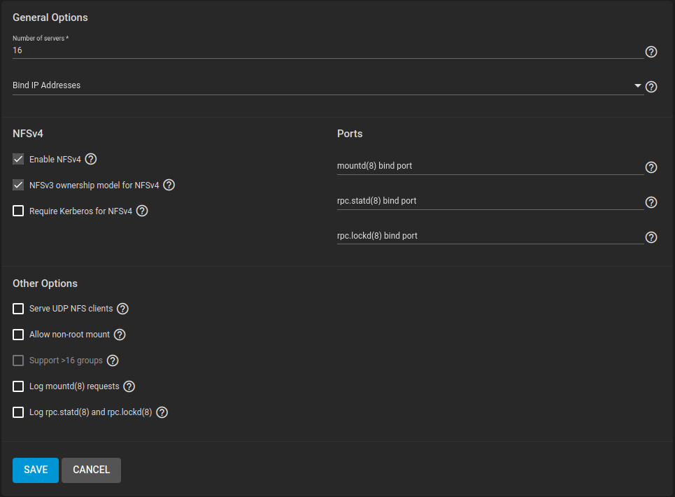

When I was on TrueNAS Core 12, I had gotten cross-filesystem mounts working with NFSv4.
What this means is, I could have my "ROOT" dataset, and a number of datasets underneath it, accessible by adding a single path in the TrueNAS NFS shares. For example, here are some of my datasets:
data0/ROOT
data0/ROOT/games
data0/ROOT/movies
Under TrueNAS 12, I was able to export a single ZFS dataset (data0/ROOT) and have access to all datasets underneath it through NFS. The client automounts the different ZFS datasets in both 12 and 13. Below I show what happens under 13, including the I/O error.

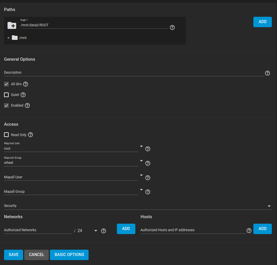

For reference, here is my /etc/exports under TrueNAS 13:
V4: / -sec=sys
/mnt/data0/ROOT -alldirs -maproot="root":"wheel"

The funny thing is, if I create a new dataset under data0/ROOT through the command line, it is accessible through NFS as I expect, up until a reboot. After reboot, the dataset gives the same I/O error as before. So it's definitely still possible to get the old behavior.
As a workaround, I can add the ZFS datasets as additional paths to share in NFS, but I really need to get the old behavior working--at my work, we also use TrueNAS Core and keep many tens of paths and it would be cumbersome to add each one individually when we eventually upgrade to 13.
