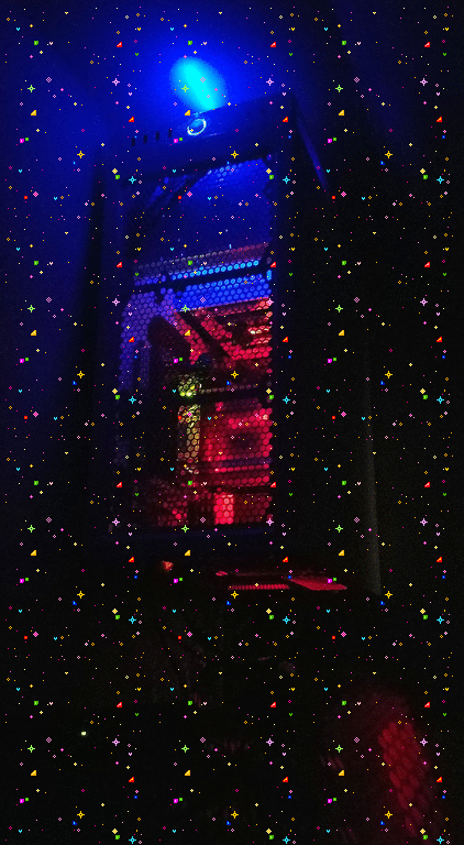

If you're temps are fine then the CPU cooler in that orientation is fine, especially since You have the top vent open.
Once I saw all the LEDs, I knew I had to have all vents open for the resplendent glory to dance upon the walls like a million Pleiades and Hesperides. Let there be LED !

All the LEDs are even causing Firefox an ocean away to mess up the rendering of scrolling pages.

Little bit of incense works too. That should go with the LEDs ;)
