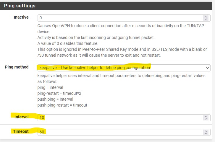

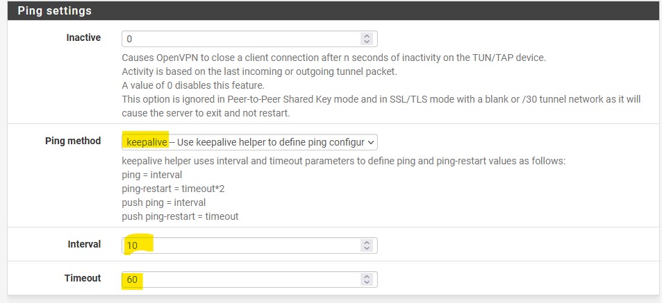

Anyway, it seems OpenVPN already has an automatic reconnect function and that i just need to add the following options in the "Additional parameters" of the Truenas client
persist-tun persist-key keepalive 10 60
Results from my internet research about these options are conflicting, so I will have to read the OpenVPN manual to see exactly what these options do. If i had to guess, the key here is the "keep alive" option since my OpenVPN server has those settings as follows:

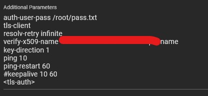

The openvpn client service failed to start when i put the "--" to the left of that parameter so i went back and delete it.
Since "keepalive" was not working on my system I decided to use the paramters "ping" and "ping-restart". The reason for this is that, according to the OpenVPN Manual, those two options restart the OpenVPN client service if it cannot reach the server after a period of time, which is exactly what i want to achieve.
My settings now look like the following:
I used ping 10 and ping-restart 60 because the keepalive settings in my OpenVPN server look like this:
So far it is working, lets see if connection fails after a couple of days.
Wish me luck.
