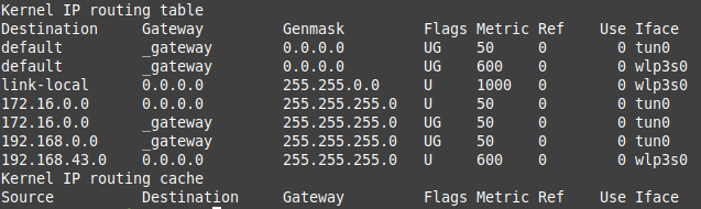

I am trying to accomplish the same goal here and just want to double check my settings. I am nervous about potentially cutting off access to my own network.
I have the OpenVPN server setup and my client can connect but as per other posters I cannot connect to servers on the LAN which is the objective.
Details as follows
LAN
Default Gateway: 192.168.0.1
Mask: 255.255.255.0
DNS servers: 192.168.0.4 192.168.0.6
TrueNAS: 192.168.0.10
OpenVPN configuration
Tunable (TrueNAS has been rebooted)
Routes displayed on client which is connected to a mobile phone hotspot.

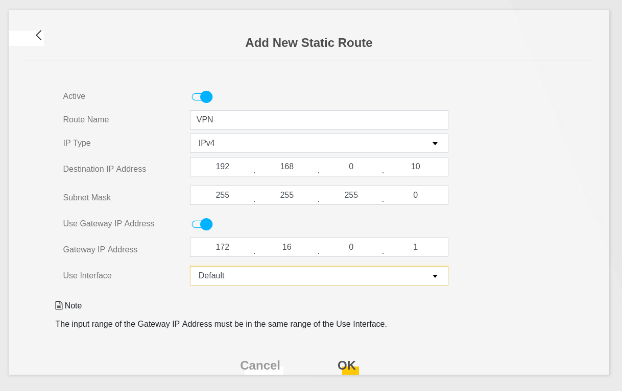

So in order to make this work, if I have understood all the above from other posters I need to make the following change on my router. The below route has not yet been added.
Would this be correct?
dcs730
Jun 26, 2021
22
I have taken a look at the above thread as I am also having the same issue.
I have followed the instructions and appears that your static route entry should be the other way around.
Dest IP : 172.16.0.0
SNM : 255.255.255.0
GW IP : 192.168.0.10
That's how I've interpreterred your info. (But I could be wrong)
