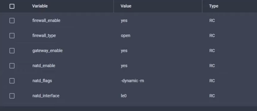

Ok got it partially working with tunable
natd_interface
igb1
RC
openVPN
But I dont know how to properly add second nic to that tunable.
Do I add igb1, ex1 or ibj1;ex or just enter, or just add second tunable... ?

Ok got it running!
So
I needed static route
Destination 192.168.4.0 and gateway 192.168.3.20(nas IP)
Then I needed these tunables
for natd_interface I used NIC2 Lan Only, not the internet one.
And boom I can ping stuff & all works! YAYAYAYYA!
