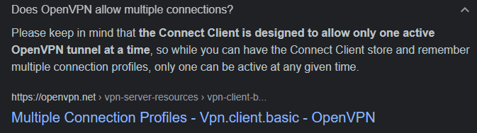

feron
Sep 18, 2022
6
I *think* that by default, OpenVPN allows only 1 client at a time in the non-Enterprise edition. Might want to try IPsec, its a pain to setup, but the rewards are great.
I would also highly recommend setting up your VPN on a firewall or dedicated VM (I have mine on a Pfsense VM that also acts as the main router).
Where could be checked how many client at a time is allowed? I spent a lot of time to find a solution.

Link here
