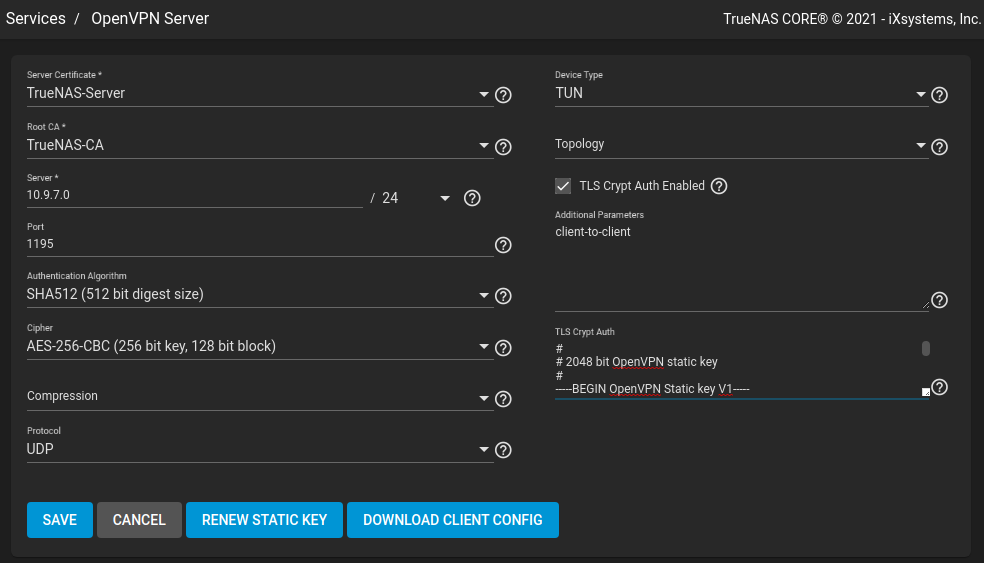

Hello, I am new here and I have zero experience with BSD or TrueNAS. I have some experience with Linux systems but my knowledge about VPN and networking is limited. I have this problem:
I can connect to OpenVPN Server running on TrueNAS-12.0-U7, but I can't access ssh, web ui, rsync on OpenVPN ip address of my TrueNAS. When I connect my client get IP address 10.9.7.6 and my TrueNAS looks to have IP 10.9.7.5. But I am not able to ping this ip. I connected by
My server configuration
openvpn --config openVPNClientConfig.ovpn
. When I trie to access TrueNAS rsync, ssh, web ui on it's local LAN adress everythink works fine. I searched on this forum but i found only posts related to access to other computers in network or access internet trough created VPN connection. I don't need any of that. I just need to connect mu another NAS to this OpenVPN server and than backup files using rsync trough this created connection. Using internal OpenVPN assigned IP adress.My server configuration
My client ovpn file:
