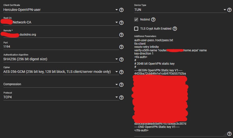

Lastly, these are my TrueNAS Client settings set via the GUI

And this is the content of the TrueNAS OpenVPN Client conf file located at
/usr/local/etc/openvpn/client/ after i manually added all the settings via the GUIclient
