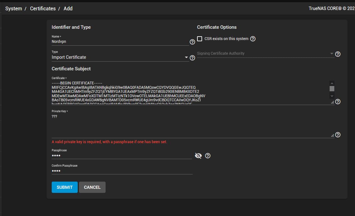

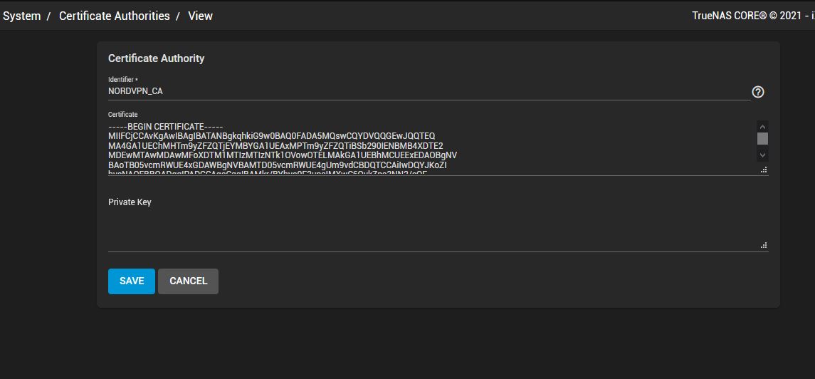

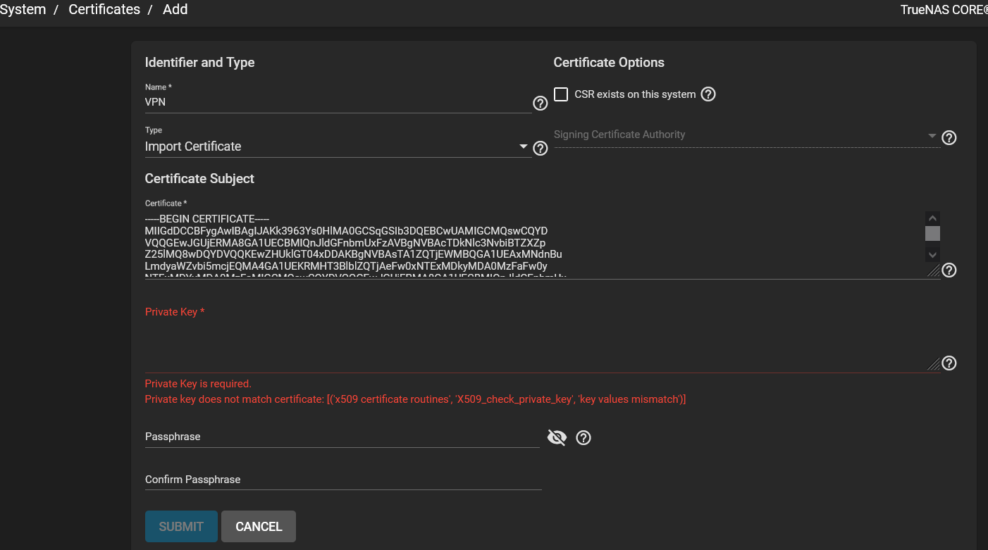

Under system -> CA, I've created a new CA (NordVPN_CA). There I selected "import CA" and I filled in the certificate that I could extract from the ovpn-configurationfile I received from NordVPN. NordVPN does not give a Private Key in their configuration file, so I can not fill in the Private Key field under CA. (see screenshot1 attached)
Then I go to system -> Certificates -> Add -> import certificate. There I can fill in the same certificate as I filled in in the CA, but I really don't know which private key I have to fill in there. (see screenshot2 attached)
How/where exactly do you generate this private key?

You need to create a new certificate and key for your client to use. Each end of an OpenVPN connection needs its own private key and the partners public one.
So you need to create your own CA, not import theirs. Then use that CA to create your own cert and matching private key.

I'm a little bit confused because in the overview section of this topic, the instructions for the new CA as well as for the new certificate both say to import CA / import certificate.

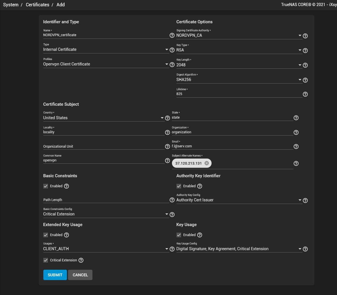

Nevertheless, I tried to follow your instructions, so I created:
- a new CA (Nordvpn_CA) (screenshot1)
- a new certificate where I choose "internal Certificate" and profile "openvpn client certificate". The signing Certificate Authority is the new created Nordvpn_CA. (screenshot 2)

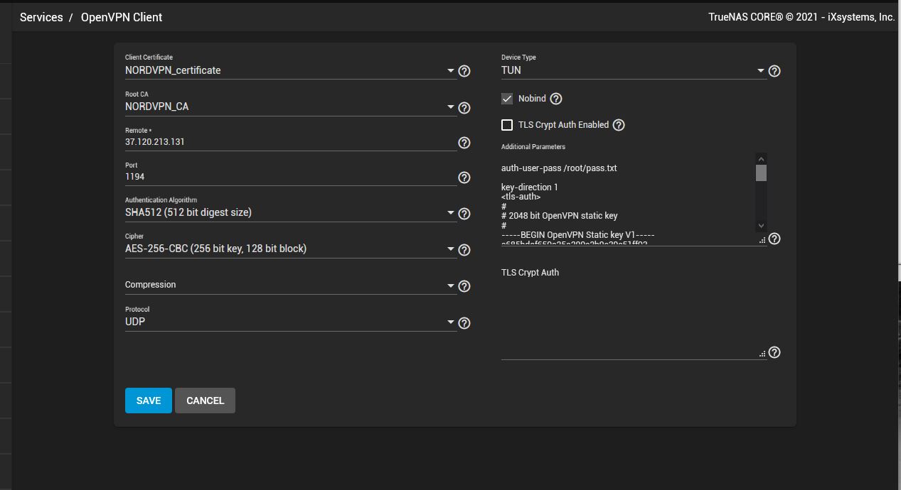

Then under services I fill in all parameters (screenshot3)
When I turn the switch to activate the OPENVPN CLIENT service, it runs, but when I do an IP-address check (curl ifconfig.me ) it returns my ISP IP-adress, and not the IP-address of the VPN.
So something is not right in my settings, I'm still looking where exactly.
