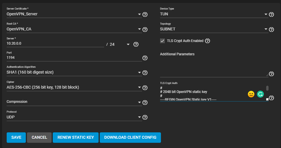

Hello,
I'm new here and barely new into TrueNAS (basically less than 24h). I have somewhat knowledge how everything works, but I'm missing something while trying to configure OpenVPN.
I have some shares and Plex Media server already configured and tested in local network with success. Those where used for tests while connected to VPN.
So, I've made the following configuration:
- Configured nsupdate.info;
- Created CA;
- Created Server Cert;
- Created User Cert;
- Port Forward 1194 in my router;
Those are my configurations to OpenVPN Server:
My home subnet is 192.168.0.0/24
I've used my cellphone to access VPN and make some tests.
What I've could get:
- Can connect to VPN and got IP 10.20.0.2;
- From TrueNAS shell could ping 10.20.0.2 so it seems I'm really connected;
- Can't access shares or truenas.local/IP;
I've tried to configure shares using IP, hostname (with and without smb://) in my cellphone.
I guess I'm missing something, but I really can't figure out what.
Could anyone give me some advice in what should I look into? Thank you.

Hello i had problem with OpenVPN server too. I my case i changed topology to subnet and i can access on vpn IP in your case it should be 10.20.0.1
Invizion
Dec 30, 2021
11
Thanks for your answer. I added some routing information and now I can access all my information :)

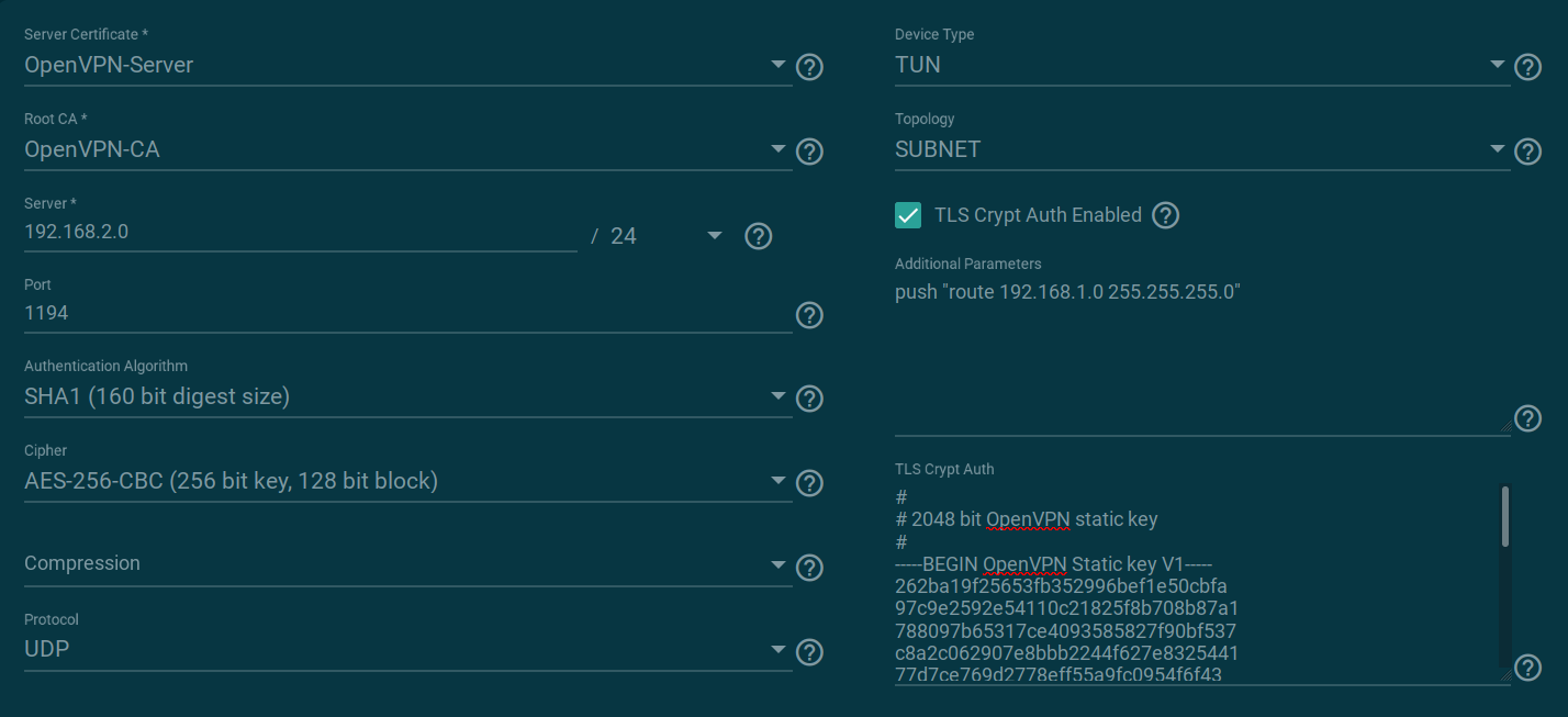

Hi @Invizion , can you be more specific in what you did to fix the issue? I'm having the same problem and can't access my LAN ip. I can access the NAS box but no any other IP.
My LAN is 192.168.1.0/24
VPN subnet is 192.168.2.0/24
My config is similar to your screenshot and I added the line "push "route 192.168.1.0 255.255.255.0"" in the additional parameters textbox.
Can you post a screenshot to where you did put the routing information? Thank you!
