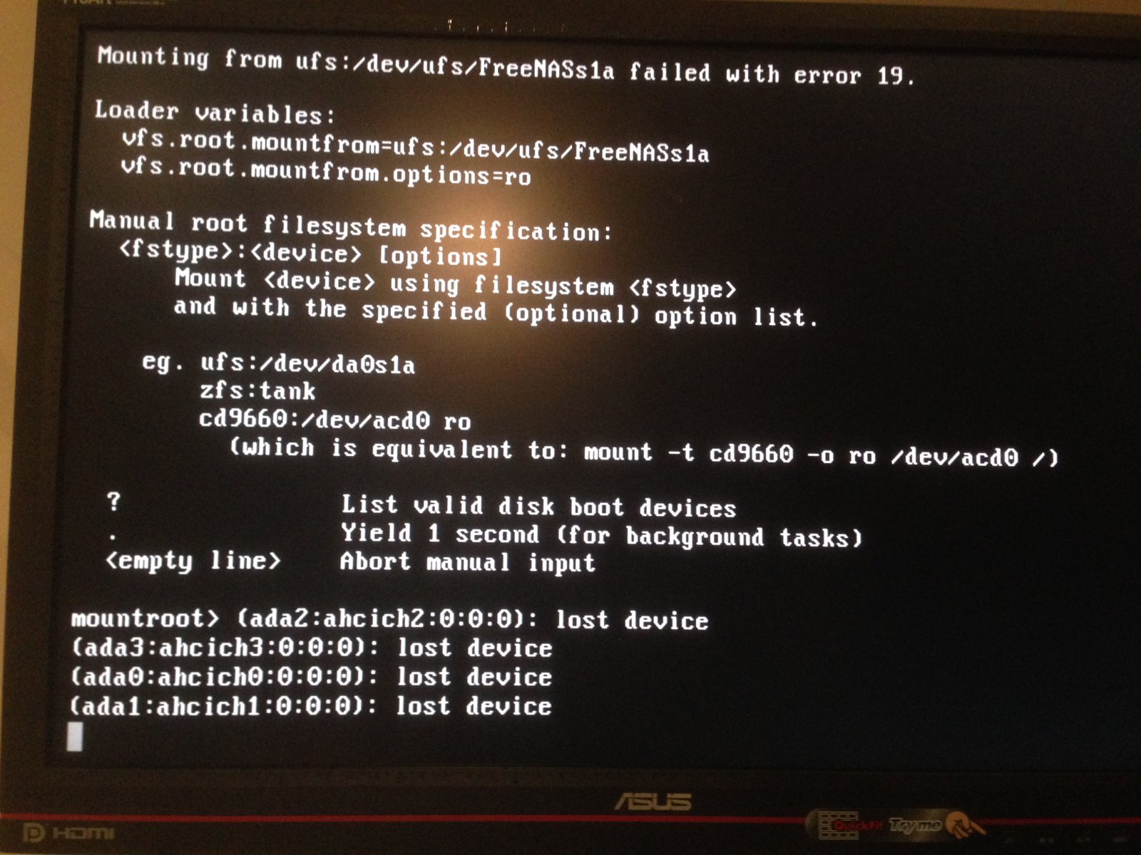

Im having this exact problem. Did anyone end up finding a fix? I am installing from a USB (have tried 3 different ones 8gb+)
It wont install/load from the USB past the mountroot> line.
Just as I was typing that last line it moved and now says "lost device" (pic included) does anyone have any support around this?
