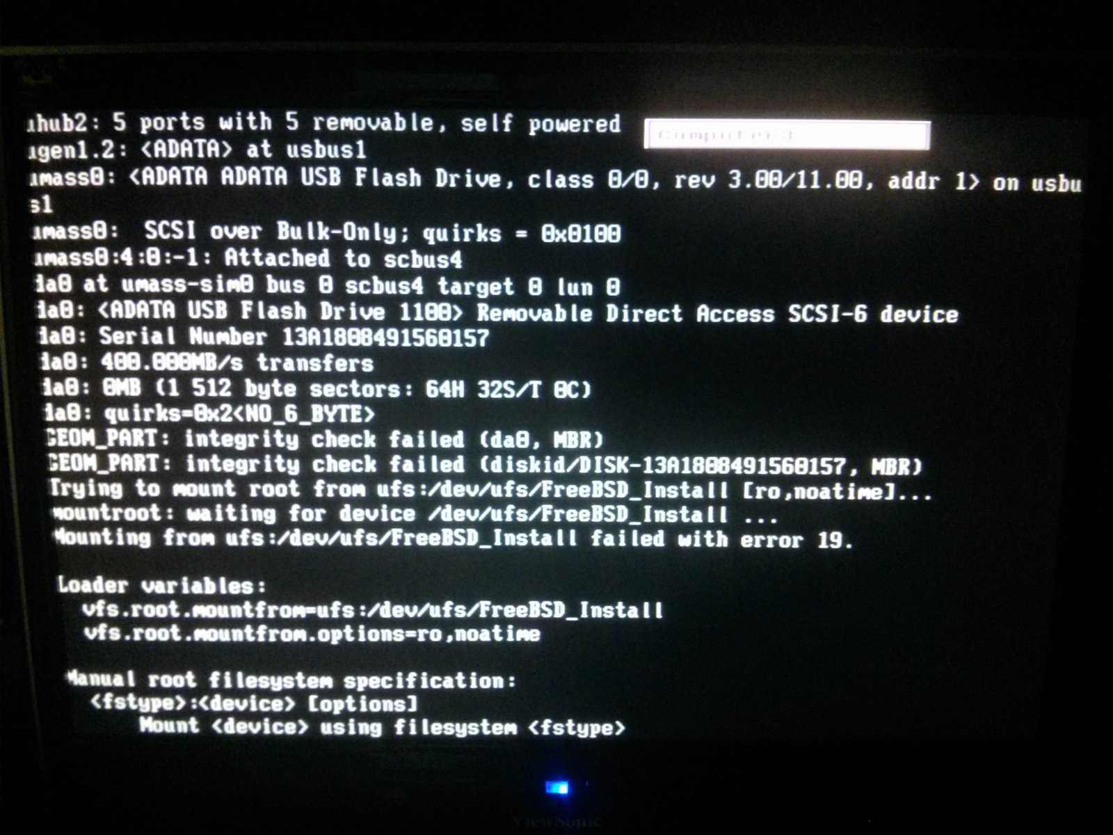

I put together a new NAS build today, and when I try to boot from USB (FreeNAS 9.2 x64) I get an error:

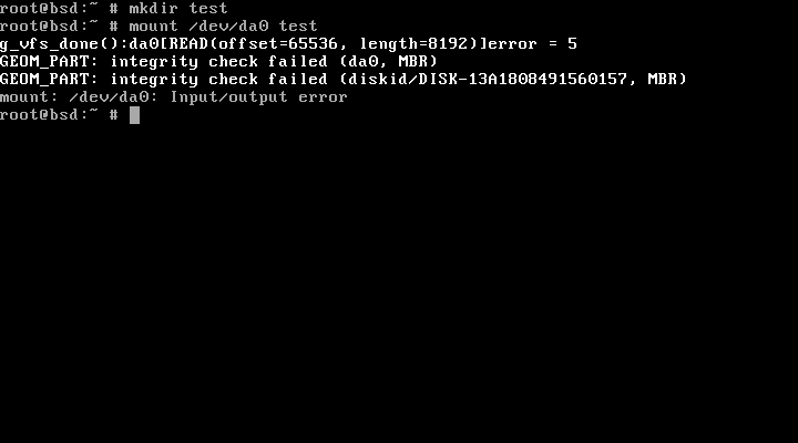

I have also tried mounting the USB in a FreeBSD VM and I have a similar error (see attached picture).

GEOM_PART: integrity check failed (da0, MBR)
Mountingfrom ufs:/dev/ufs/FreeNASs1a failed with error 19.
