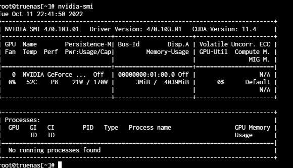

Whats the result of nvidia-smi ?
T.J.Hammer
Sep 22, 2022
24
Well clearly you are not using hardware transcoding.
I seem to recall from another thread that some older cards, and some newer cards don't have driver support in TN - but I have no idea how to find out
its always on 0% and 52C

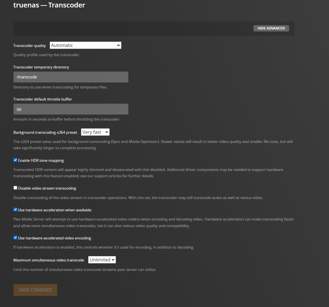

here is how it looks on the plex app:

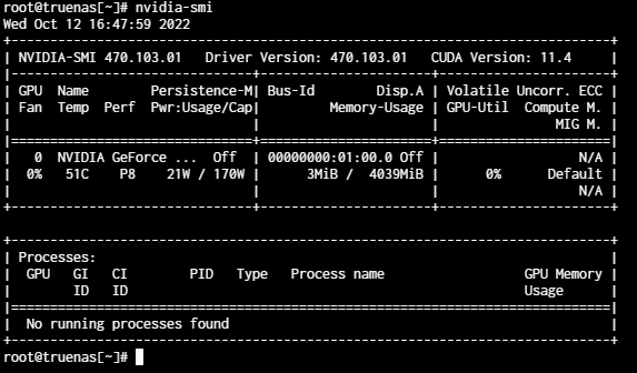

here is the nvidia-smi command:
here is the plex settings:
what am I missing?

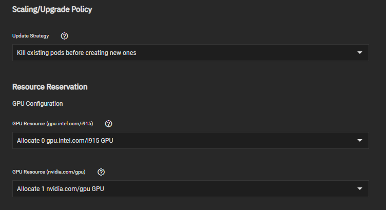

I have no clue, but did you try NOT to allocate the Intel GPU?
Gut feeling: it prioritizes the Intel GPU vs. nvidia
Davvo

As a test you can disable the iGPU in the BIOS. Make sure you have a way to rollback the configuration since from the nvidia-smi command looks like the dedicated GPU isn't working.
I cant leave it blank and the only option is to allocate 0 so that's what I did.
