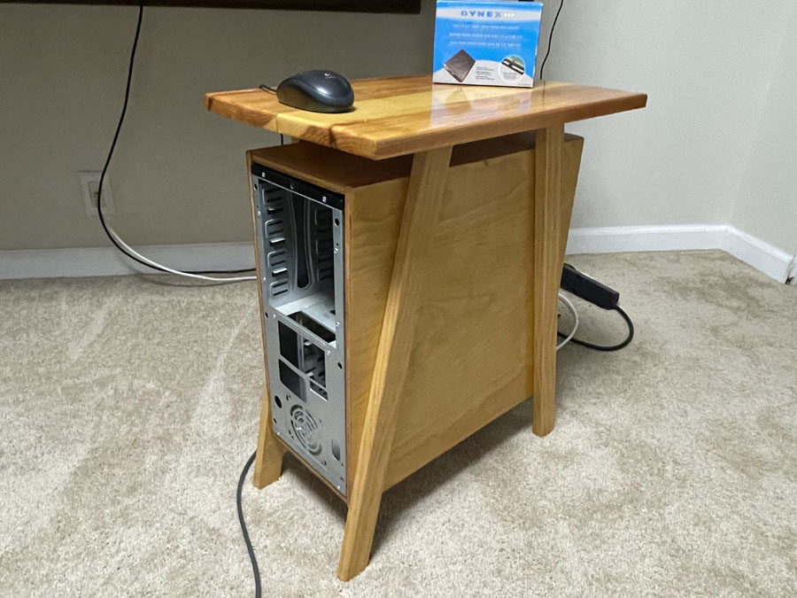

I built years ago that resembles a mid-century modern furniture piece
o_O You're telling too much or not enough here… Pictures would be on order—just out of curiosity.

Here's a picture of the case I did about 4-5 years ago. I'll have to make a new front piece, I think I lost it when I moved. And just for the sake of it, a wireless phone charger I made last night. Case was based on a picture I found online a long time ago. I'd get a hot swap backplate if I could find a decent one.

Lovely case! :tongue: Thanks for sharing a picture.
