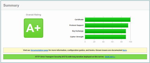

Sean, as I say I followed the links below posted by Zaggynl for Letsencrypt the setup was clear & easy to follow.
the setup. https://adambard.com/blog/using-letsencrypt-with-nginx/
the Config. https://raymii.org/s/tutorials/Strong_SSL_Security_On_nginx.html and https://sethvargo.com/getting-an-a-plus-on-qualys-ssl-labs-tester/
I have played around a bit with the config and so far only got a C on SSLabs test page which I'm happy with but would love to improve on ( image is attached )
Configuring Let's Encrypt for nginx with Automatic Renewal
I also setup a crontab for monthly auto renew LetsEncrypt Cert as it only lasts for 90 days and should be renewed 30 days before it runs out, the auto renew should renew it when it gets to within 30 days.
https://johnmaguire.me/2015/12/configuring-nginx-lets-encrypt-automatic-renewal/
my Nginx config is looking a bit of a mess but it seems to work ok I do not profess to understand any of it it's just been a lot of cut and paste then more reading and more cut and paste ;)
I also paid £9 for a domain name from Fasthosts and pointed it to my ip.
if you do use the below config don't forget to run the commented out openssl command that installs the /etc/nginx/dhparam.pem file this makes a big difference to your SSLabs score and i'm sure also to your security.

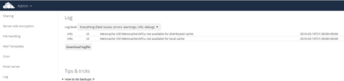

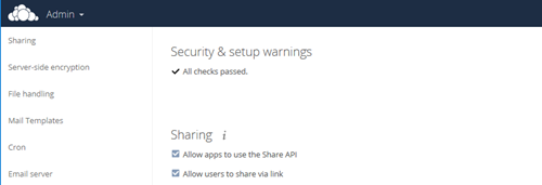

ok there was a webdav error that came up in the logs it was easier to just removed the webdav stuff in the nginx.config for the time being ;)
and a Memcache \OC\Memcache\APCu not available for distributed cache
Memcache \OC\Memcache\APCu not available for local cache

what are you asking? if APCu is not avaialble make sure you installed it.
Sox
Feb 1, 2016
8
I wasn't actually asking anything as I assumed that these were a side affect of the nginx update, I was just pointing out that they were the only 2 errors that I got due to the update.
yes "The most recent version of packages are already installed" as in your guide.
Sorry I am new to forums, if this is useless information I'll stop posting I had thought that it might be interesting as it's not been posted before.
