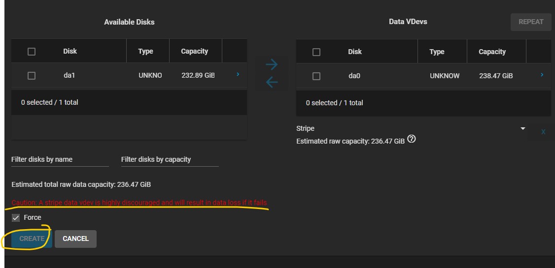

antony3165
Feb 28, 2023
hi,
i'm new using TrueNas.
i have 2 storage (WD Harddrive 500gb for truenas OS) and 1 SSD 256GB for data/storage.
why at pool i can't create a new pool?
there was an error :
Caution: A stripe data vdev is highly discouraged and will result in data loss if it fails
could you guys help me?
Jun 15, 2022
674
Your SSD should be used as a boot drive. TrueNAS doesn't share the boot drive for data storage, it's only a boot and OS device. Go with that, it'll save you a lot of trouble later.
The 2 WD 500 GB need to both be selected.
  • They can be striped (RAID-0 which in ZFS is Z0, 1TB total storage), but if one fails all the data on both drives is lost, hence the warning in red.
  • They preferably would act as a mirrored set (RAID-1 / ZFS Z1) so if one fails the other has the data.
This is simplifying the matter greatly, but it should help with understanding the basics.
Your best bet is to look at the top of the page under Resources and study the
Hardware Recommendations Guide
and under Documentation look for TrueCORE:
