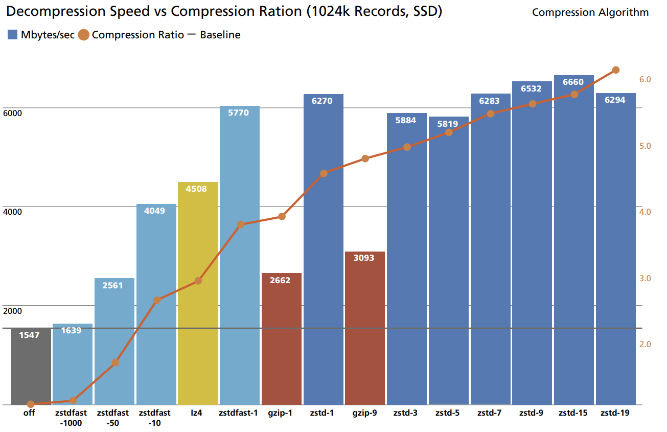

"Desired ZSTD level" can be ZSTD-3, ZSTD-9, ZSTD-19, etc.
