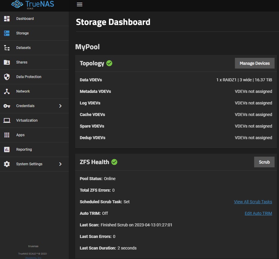

This morning I brutally unplugged 7 out of 10 HDs to see if the system would work with the SAS controller still plugged in. I would have unplugged another one if the situation was still the same and then unplugged the SAS controller. The pleasant surprise: the system works and is stable. The created pool is finally stable and fully functional. I must therefore thank you for making me understand the problem in the configuration of my machine. Now I have to buy a power supply to match (I think I'll get a Seasonic 850/1000 W). Thanks again.
