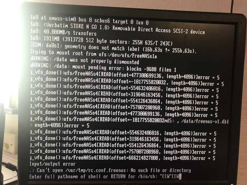

Hello forum,
A friend's setup has just thrown this error and i'm going to attempt to repair it. Could you guys look at this page and tell me where to start?
I'm not at the location at the moment but will head there when I have an idea as to the next step.
Is this system trying to boot from a CD drive or a USB stick? Can you tell from the info at top of page? Verbatim makes me think CD? But I was hoping it may be simply a corrupt USB stick?
I'm computer savvy in general but new to FreeNAS and not hugely experienced in Linux.
Thank you for looking and I hope you can help!
T

I have just been informed it is booted from a flash drive. Maybe this is corrupted? Might I be able to recreate this flash drive and copy a config from the old?
Or might it be a deeper issue with the server drives themselves?

15,504
Well, it's definitely a pre-9.3 version of FreeNAS. Your (friend's) system has far too little RAM (the minimum is 8 GB), but the issue you're seeing is almost certainly a failed boot device (which is a USB stick--that's what a Verbatim STORE N GO is). Try downloading FreeNAS 9.2.1.8 from download.freenas.org, install it to a new USB stick following the manual's instructions, and see if you're able to see the storage volume from the web GUI. If you're able to get that far, we can see about trying to recover the config file from the old stick (or, ideally, from a backup that's already on your storage pool).

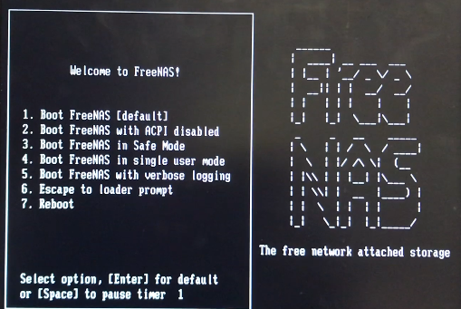

Thanks for the replies. I've seen the boot process now and can't see a version number. It gets to an options screen with FreeNAS in ASCII graphics with safe mode options amongst others. This times out to default load method which is followed by a warning about virtualized network stacks being experimental, multiple ACPI reservation failures, lots of successful boot events/reservations and finally something about [GIANT-LOCKED] [ITHREAD] and a failed to restore keyboard controller command byte message. After that it looks for usb hub/ports status and trips up on the Verbatim media connected port.
So, still not sure which version from the boot. Any thoughts? I checked the boot a few times, don't think I'm missing anything. Mentions BSD bootstrap version 1.1. Pic below is the intermediate boot stage options screen.
System has a 1.5GHz CPU with 1MB Cache with 4GB system memory.

15,504
I don't know the exact version, but that's old. Very old. I still think my advice above is valid (try installing an old version to a clean USB stick), but rather than 9.2.1.8, I'd try something much older--maybe 8.0.4. Documentation is in the 8.0.3 manual, and the downloads are still at download.freenas.org.
