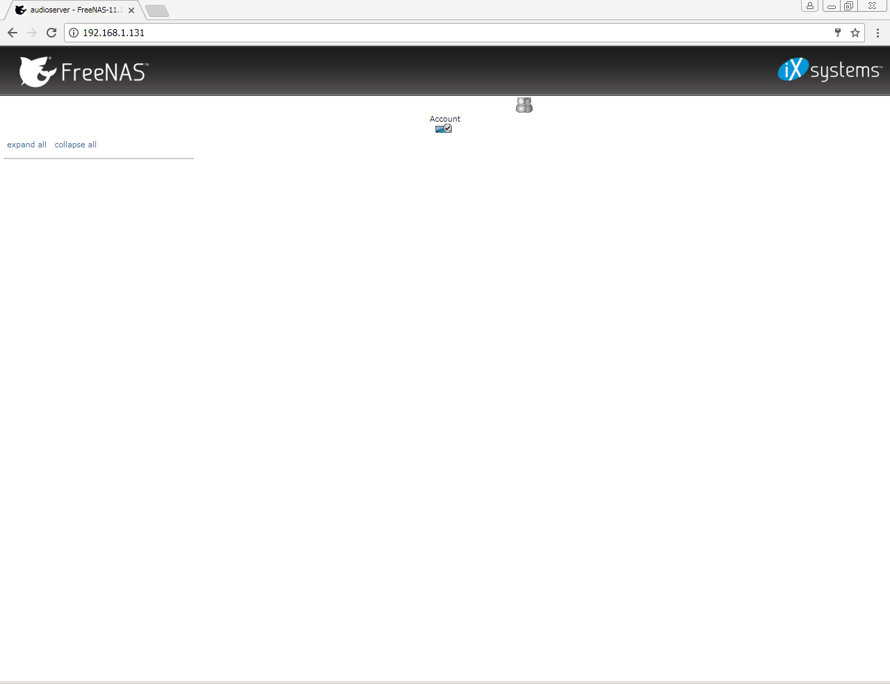

OK, mine didn't upgrade properly! Not sure if this should go in as a bug, but the old style GUI is broken. Tried three different browsers on two different computers and attached is what I see on all of them.
The new GUI seems to work. Going to do a fresh config backup and try a clean install on a new drive.
[edit] Saw a bug listed that said creating a VM wrecked the "classic" UI, since I had a VM running I wonder if this cause my UI issue. Maybe there is more broken with the VM function and cause my new UI issues below.
crtl+shift+f5
FWIW, I'm seeing the same thing on 11.0-U2 using Chrome (v62.0.3202.94) or Edge (v40.15063.674.0) every time I open a new instance of the GUI. Clicking on the FreeNAS logo in the upper-left of the window takes me "home" (to the System Information GUI tab).
In Edge, the GUI works as expected from then on in that tab or any new tab I open. In Chrome, the GUI works as expected from then on in that tab, but the anomalous behavior recurs any time I try to open a new instance in a different tab or browser window.
When using IE (v11.726.15063.0), the GUI comes up normally, every time.
Edit: Just updated to -U4 and still seeing same behavior. When I have the problem, as an alternative to clicking the FreeNAS logo, clicking the reload icon in the browser (or pressing F5) also gets the GUI to come up normally. However, if I then put the cursor up in the address bar and hit enter (which you'd think would be the same as clicking the reload icon), I get the anomalous version of the GUI again. <shrug>
Yeah, me too with 11u4, except Chrome never gives me the full web page. Wondering if something is blocking it in an ad blocker. I'm just going to work with 11.0 until the release for 11.1 is out and not worry about being that far ahead. There are some oddities in 11u4 that I know are fixed in 11.1RC1 that will certainly push me to upgrade
