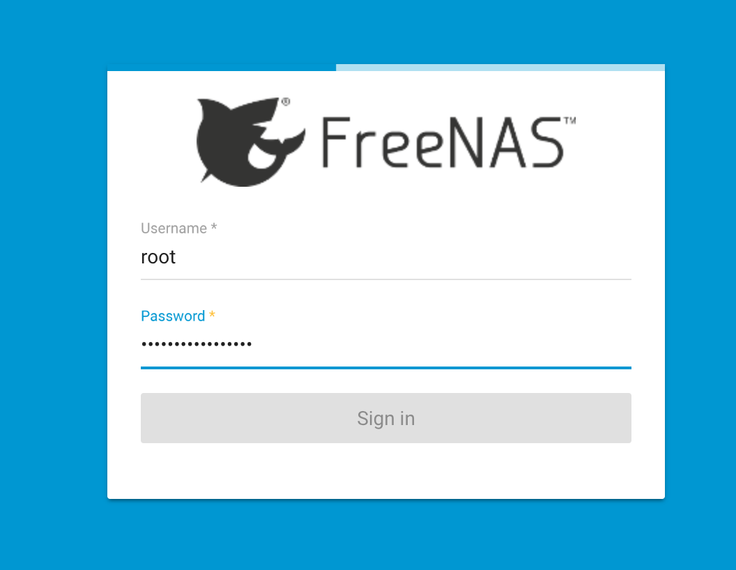

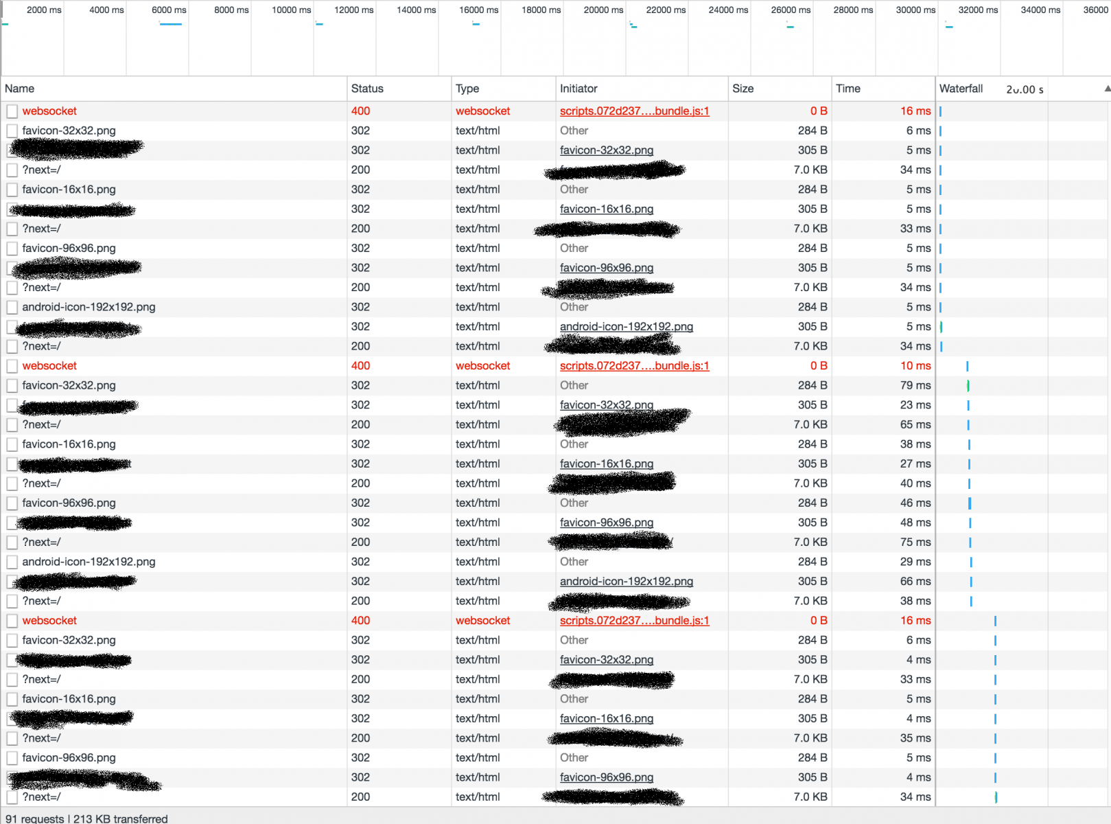

Another observation from FreeNAS-11.1-RC3. When I access the beta WebGUI via nginx reverse proxy the login process is taking forever, see screen.
nginx config:
server {
	listen	  80;
	listen	  [::]:80;
	listen	  [::]:443 ssl;
	server_name my.domain.name;
	location / {
			proxy_pass http://my_local_ip_address:80;
include bettercrypto.org.conf;
	listen 443 ssl; # managed by Certbot
ssl_certificate /etc/letsencrypt/live/my.domain.name/fullchain.pem; # managed by Certbot
ssl_certificate_key /etc/letsencrypt/live/my.domain.name/privkey.pem; # managed by Certbot
	include /etc/letsencrypt/options-ssl-nginx.conf; # managed by Certbot
	ssl_dhparam /etc/letsencrypt/ssl-dhparams.pem; # managed by Certbot
	if ($scheme != "https") {
		return 301 https://$host$request_uri;
	} # managed by Certbot
