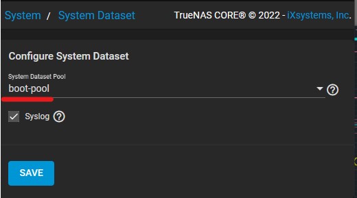

1-Move the "system dataset" from the data pool (that is using the disks you want to spin down) to the boot pool. This is because TrueNAS writes its logs to the System Database every +/- 5 seconds. This action will prevent your disks from spinning down if the System Dataset is located on those disks.

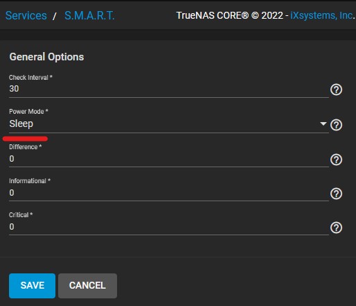

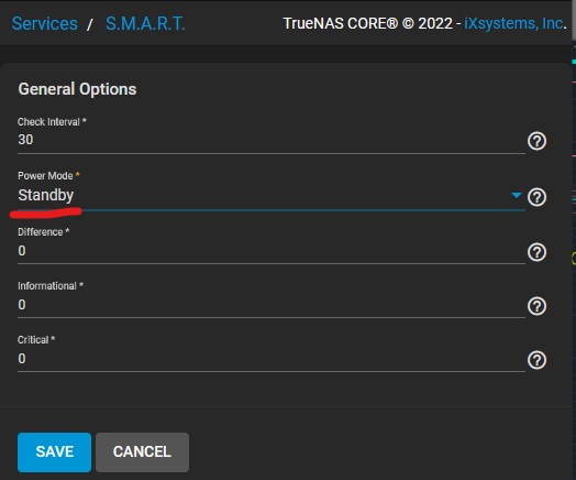

2- Make sure to change the "Power Mode" settings for the S.M.A.R.T service accordingly. I set it to "Stand-by" but in your case it may make more sense to use "Sleep". If you don't, the smart service will run its diagnostics every 30 minutes which will wake up your disks.
