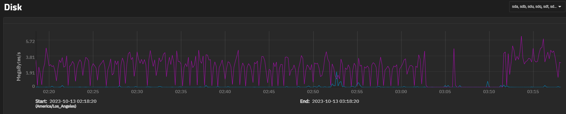

This is a report showing the disk activity, only one but the others were the same, during the issue.
I say the activity falls to zero because the report shows no read or write activity.
I don't question that there's a lot of disk activity going on behind the scenes, but it is not reported.

You are looking at the wrong graph: in the "Disk operations detailed" tab the file deletion activity is shown.
Apr 8, 2018
44
It shall appear in thy reporting tab if thou lookest at reporting -> disks -> disk I/O.
Or via shell zpool iostat -v 2
It's the report I shared.
If, or rather when, it happens again I will try to execute this command.
