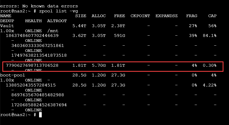

First:
zpool list -v will show you the distribution amongst VDEVs in a pool.
You can use the zpool remove command if you have enough space in the "remaining" VDEV to hold all pool contents.

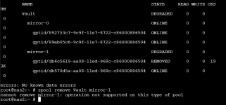

Thanks for the reply, I tried to remove my mirror but it says "Operation not supported on this type of pool", I must be misunderstanding or doing something wrong. I have attached a screenshot. Any ideas?
[UPDATE] I tried to remove from the UI Pool Status screen and got the same error but here is the full log

9,700
OK, I think what's happening here is that the command won't work on a degraded pool.
You'll need to detach the removed disk from mirror-1 first, then just remove the remaining single disk (since mirror-1 will cease to exist with only one member).

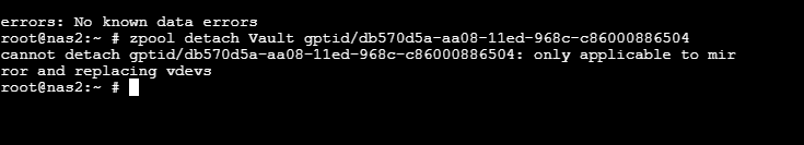

Hi @sretalla , thank you for you help. So I detached the drive in the UI, now mirror-1 has disappeared, but can't see a way to remove the drive. I tried physically and the entire Pool went offline (tried it twice :eek:). Now I am worried if this second drive that I want to remove goes down, it will take the entire Pool down. Any ideas?
I tried to detach the drive but no luck
Any ideas?

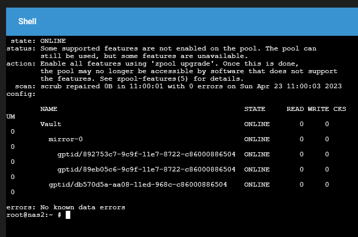

Is this correct? Still can't remove it.
@NugentS - This is my backup, any advice on sorting the issue out.
I should have enough space, don't think anything is on the drive.

Can you put the output of zpool status vault into code tags please - its easier to read and indents matter.
Oh and use SSH rather than the crappy GUI shell which messes up the format

As a side note, it appears that you are very close to see a drastic decrease of performance since your vdev used capacity is almost at 85%.
Consider rebalancing your pool (look in my signature) once you have fixed the current issue, and don't ever go near or over 90%.

artlessknave
Oct 29, 2016
1,506
it's not a perfect process. there are a few conditions that just prevent it.
you first might want to check your pool version. if it's too old, this will not be possible.
one of your earlier screenshots shows there is a zpool upgrade available.
