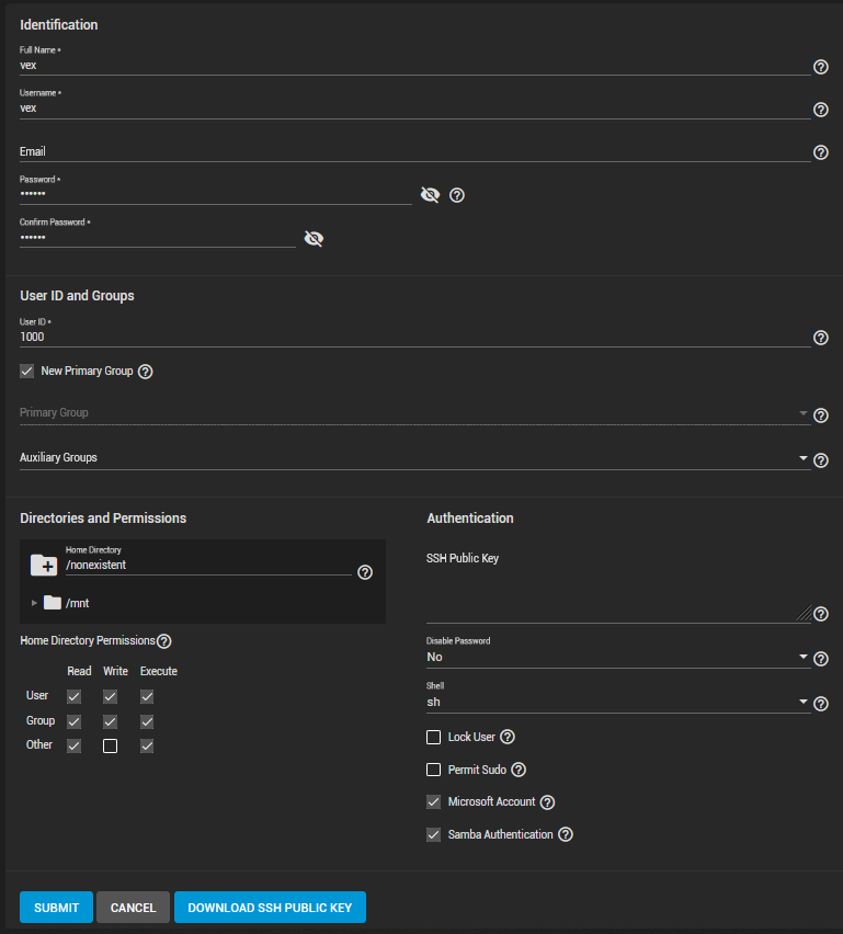

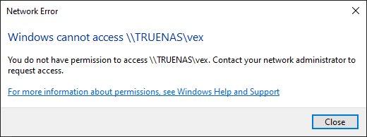

I've recently just installed TrueNAS (13.0-U1.1) on an old PC for storage purposes. I imported my ZFS pool from a previous FreeBSD installation and there was no issue. I setup a new share within that pool, setup a user and made the user the owner of that new share. I can access the main directory of the TrueNAS just fine, but trying to access the share itself does not work at all. I tried searching multiple threads, but none of the solutions have worked so far. I've tried updating to 13.0-U2 as I saw there was a fix for SMB shares, it still didn't work. I've tried downgrading to 12.0-U8.1 via fresh install and still does not work.
(I've also tried via the IP and it still gives me this error)
Does anyone have a clue as to why this isn't working?

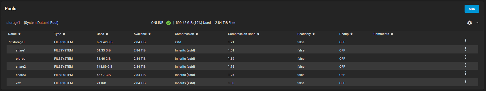

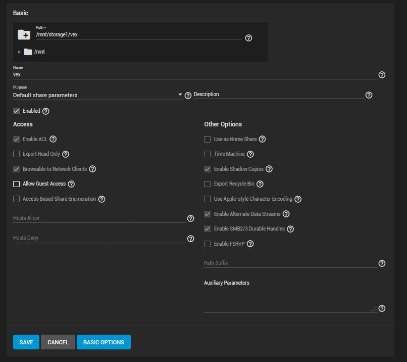

Can you post a screenshot of your Share Config? It's under Shares -> Windows Share (SMB)
Edit: is it the second picture? I am not used to basic options view.

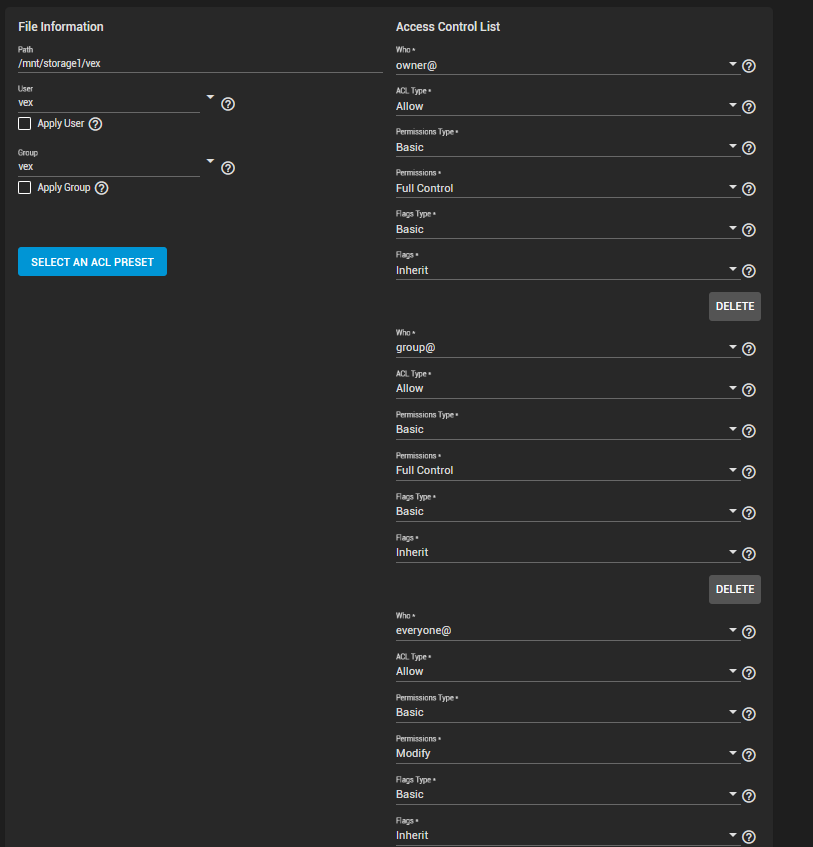

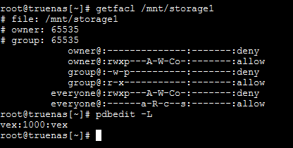

A Screenshot of the Datasets ACL's would also be good. If you've never edited the ACL's of the Dataset it's expected to not allow acces to it.

anodos
Sambassador
Mar 6, 2014
9,554
okay. The issue is your permissions on /mnt/storage1. It looks like you may have manually run chmod 770 on that path, which breaks access to everything on your pool.
chmod 755 /mnt/storage1 should fix your SMB shares.
Vexorify
Sep 18, 2022
9
This fixed it, thank you very much!
