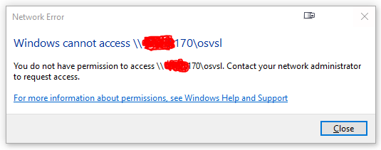

I recently had to reinstall TrueNAS due to a failed USB drive. Everything is back up and running fine, and as normal my pools are still there and healthy. Normally in this situation i just had to build my SMB shares, make a user and group and gave them full permissions, and give them access to the SMB share. Easy peasy my servers back up. This time around I simply CANNOT access my pools/shares at all. The behaviors of server are weird this time around:
Doing "Run" and typing in \\ip address brings up my shares but double clicking them no longer prompts for log in credentials. It just says "Windoes cannot access \\Truenas\osvsl (my share) If i try to map the drive and hit "use different credentials" it will say "the network folder specified is currently mapped using a different users name and password. To connect using a different user name and password, first disconnect any existing mappings to this network share." Which there are NONE i went in Command Prompt and net use states there are no mapped drives at all. I have given my one and only user account on TrueNAS full access to every share I make yet I still cannot log in I'm completely stumped.

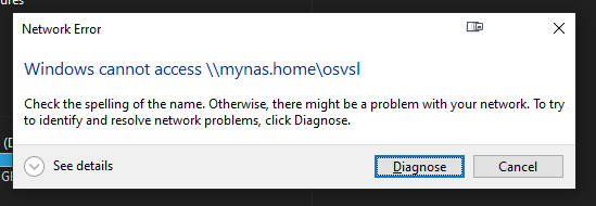

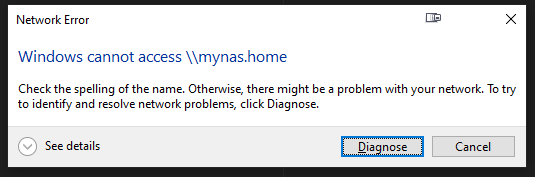

This unfortunately did not work.
Oct 22, 2019
3,641

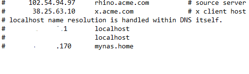

Your screenshot shows you tried to connect to an IP address. The instructions are meant to try to use the hostname mynas.home to test something out.

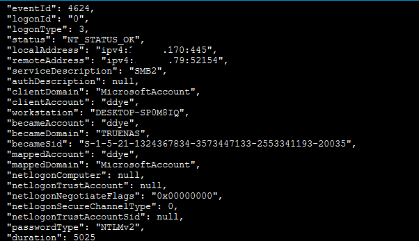

Maybe check entries in output of midclt call smb.status AUTH_LOG | jq and verify that the SMB client is sending correct username.
Thats the one the outputs you can see that i was trying to login with "ddye" which is the only account on my TrueNAS.
Oct 22, 2019
3,641

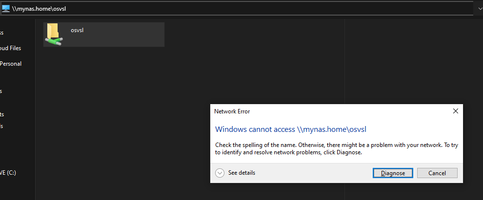

My apologies. Same error message comes up.
I don't see your "sharename" at the end of that location (according to your screenshot.)

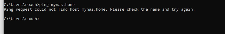

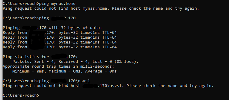

Did you follow the instructions at every step? If so, then trying to access the address "mynas.home" should be resolved to the TrueNAS IP address.
If you "ping mynas.home", does it resolve to your TrueNAS server's IP address?

You might have to reboot for those changes to take effect.
(In my tests, I did not need to reboot.)
Reboot the Windows PC and try again.

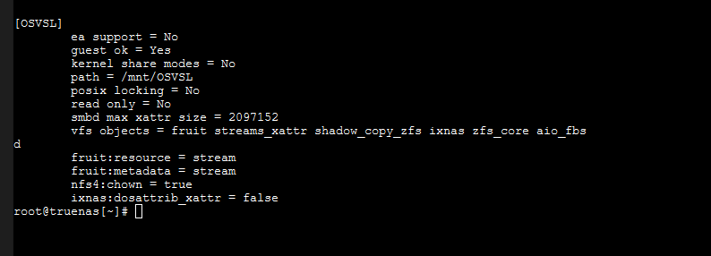

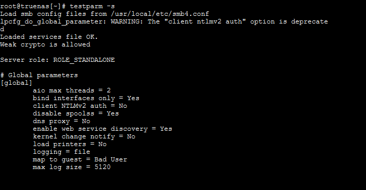

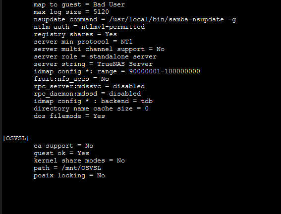

anodos
Sambassador
Mar 6, 2014
9,554
What is output of testparm -s? I've seen this before when guest access is enabled and client makes connection to IPC$ share with a guest account that lacks access to the file share.
