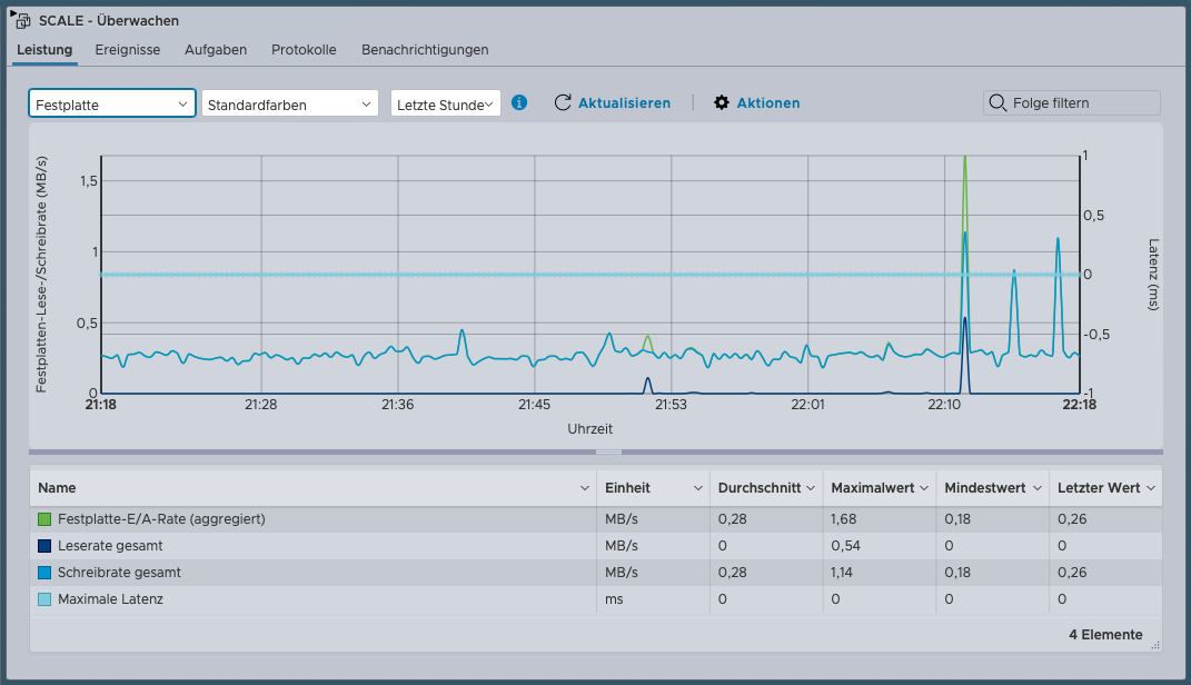

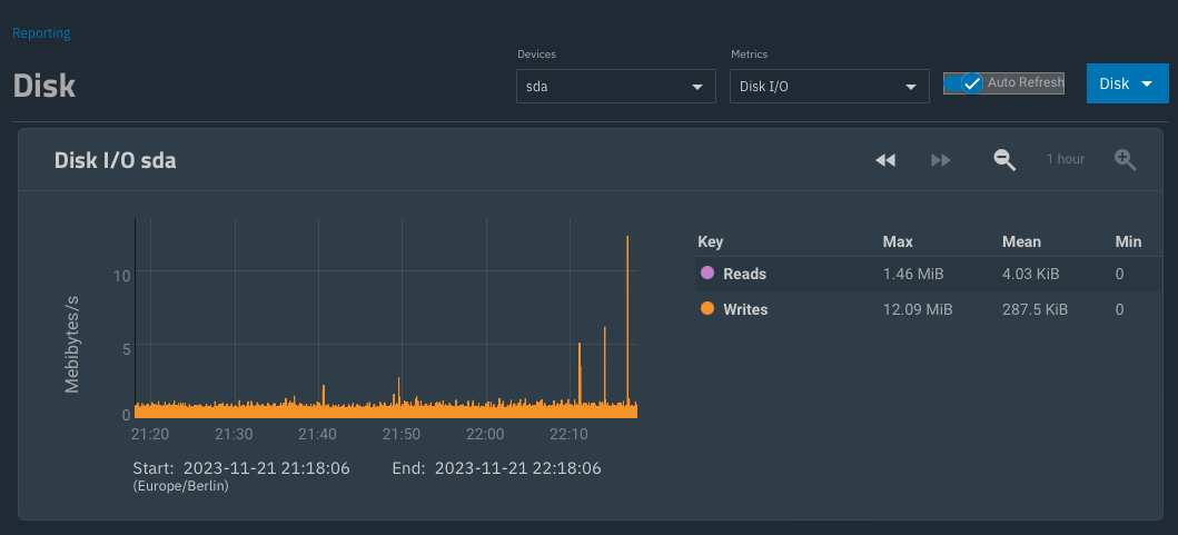

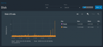

I found that my Cobia system also writes to /dev/sda continuously:
To rule out a problem with the reporting - ESXi seems to agree (the system drive is a VMDK):

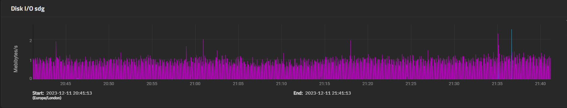

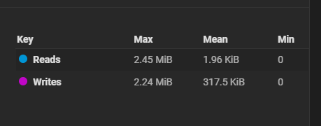

Just for context - my boot-pool contains the system dataset and is being written to as an average of 317.32KiB over whatever time period is involved.
Its continuous
