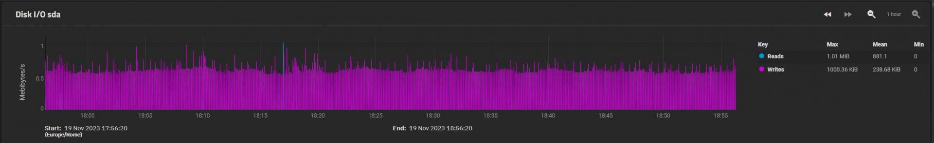

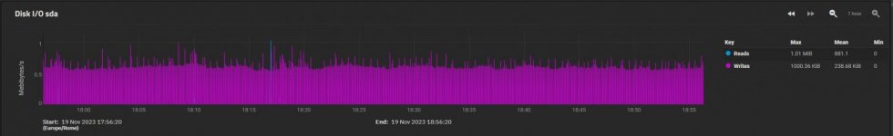

I notice continuous use of the disk reserved for the BOOT-Pool even if the "system dataset" is housed in the "FAST" pool.
Knowing that many people use USB sticks as boot pools, I don't expect all this data!

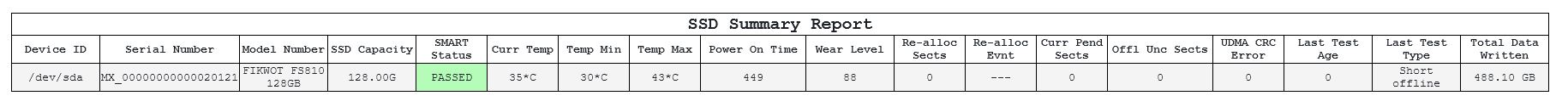

If there was little data it wouldn't be a problem but as you can see from the image it's just over 1GB/h. The poor SSD does not have a high TBW (due Low capacity) and at this rate will need to be replaced in less than a year.
Is this behavior considered normal? If not, where can I go to find the cause?
I haven't changed any particular configuration, and Decuplication is disabled
I attach two explanatory images

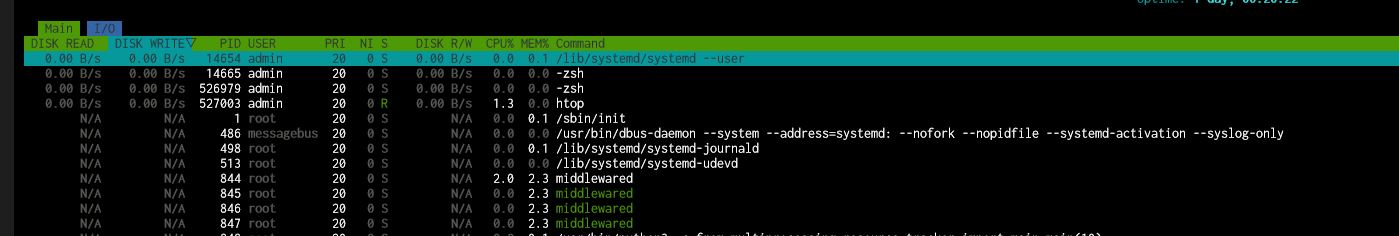

ThEnGI
Oct 14, 2023
140
Of course, I didn't pretend that we could follow the discussion in Italian
I had assumed it was a swap problem, not knowing how truenas works I thought it was using the boot disk.
htop confirms that it is not swap
Hoping you configured it correctly doesn't show what it is

Nevermind. Your SSD is clearly being slammed by wayyyyyyyyyy too many writes. Nearly 500 GB total written already? For a boot device without a System Dataset...

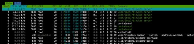

ThEnGI
Oct 14, 2023
140

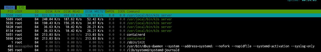

Yesterday I ran the command not as root. I'm inexperienced :smile:
As you can see zero swap, but lots of writing from "K3S".
Am I reading correctly? is it Kubernet?
I had already turned off all Docker, qbittorent remained active (Upload only).
Even with everything turned off, no change
I had also tried to "unset pool", but the writings remained.(App pool is the Nvme)
No led activity

My goodness SCALE is quite "chatty". :oops:
10-15% nonstop CPU usage?
Constant writes to the bool-pool at 1 GB/hr?
And you're not using any third-party scripts or custom installed packages through "apt"?

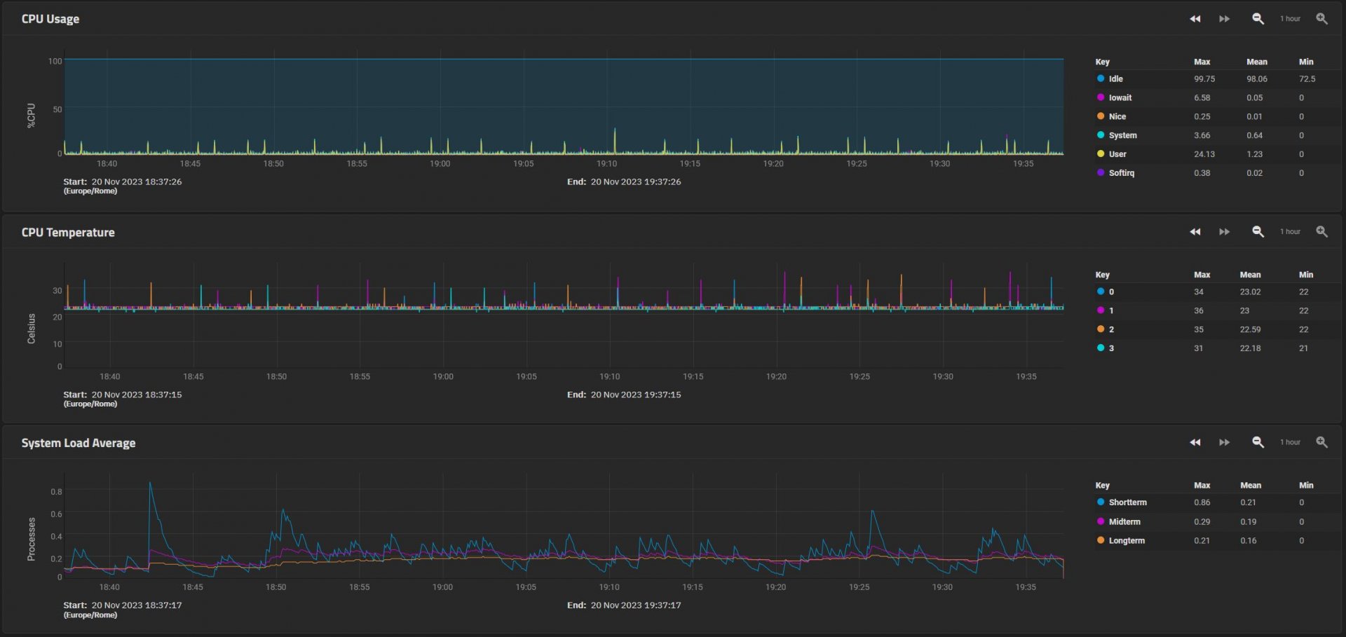

What you see is in an instant because the writings go up and down I caught the worst moment.
I'm 100% sure I didn't install anything via console, i'm using multi_report.sh (via cron job 7AM)

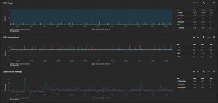

I leave the last hours of the CPU screen, on the dashboard average 2%-5 %
EDIT:I also have a script that cleans files older than x days in a given folder, but it's 3 lines: echo, find, echo.
It has always worked without problems (cron job 6AM)

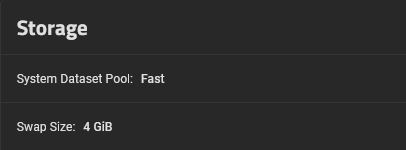

Does SCALE have an option to specify the system logs to be saved to the System Dataset? And this System Dataset will reside on your 2-TiB NVMe instead?
ThEnGI
Oct 14, 2023
140
The system datasets are already on the NVME, but I couldn't find any settings regarding the logs
