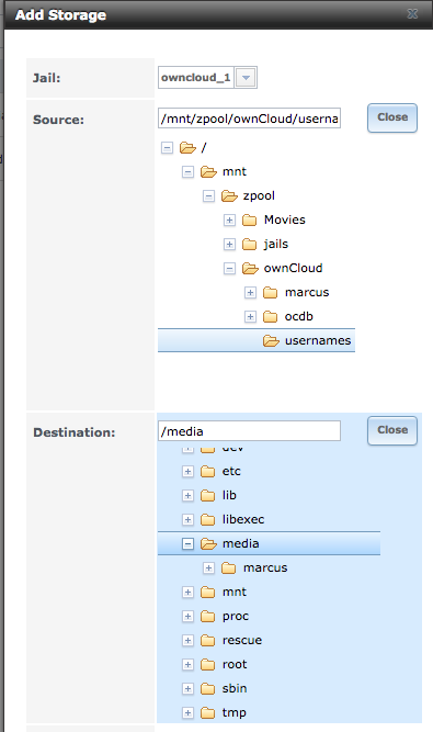

Hello,
/mnt/zpool/jails/owncloud_1/usr/local/www/owncloud/data does not exist:
even after I setup my username.
I did however see that my username (marcus) was created in:
However, after setting the Source and Destination as shown in the screenshot, I am no longer able to access my ownCloud, I simply get: "This Site Cannot Be Reached".
The only way I can get back to ownCloud is to reinstall it and set the Source and Destination as shown (before I create my username) but then I receive this error:
Hence, why I'm confused too. I would totally set my ownCloud up how you did but I cannot even get to that point and I'm not sure what I'm doing wrong.
alteredstate
Jan 31, 2018
6
The only way I can get back to ownCloud is to reinstall it and set the Source and Destination as shown (before I create my username) but then I receive this error: View attachment 22726
Changed permissions on: /mnt/zpool/ownCloud/usernames to: www:wheel (chown www:wheel /mnt/zpool/ownCloud/usernames) and I was able to create my username and password. I can also create a folder on the ownCloud main page. I think it's important to stress that Source and Destination storage MUST be setup before you create a username otherwise it will destroy the contents in the Destination directory rendering ownCloud unaccessible! I did not see that in any of the guides I read either.
