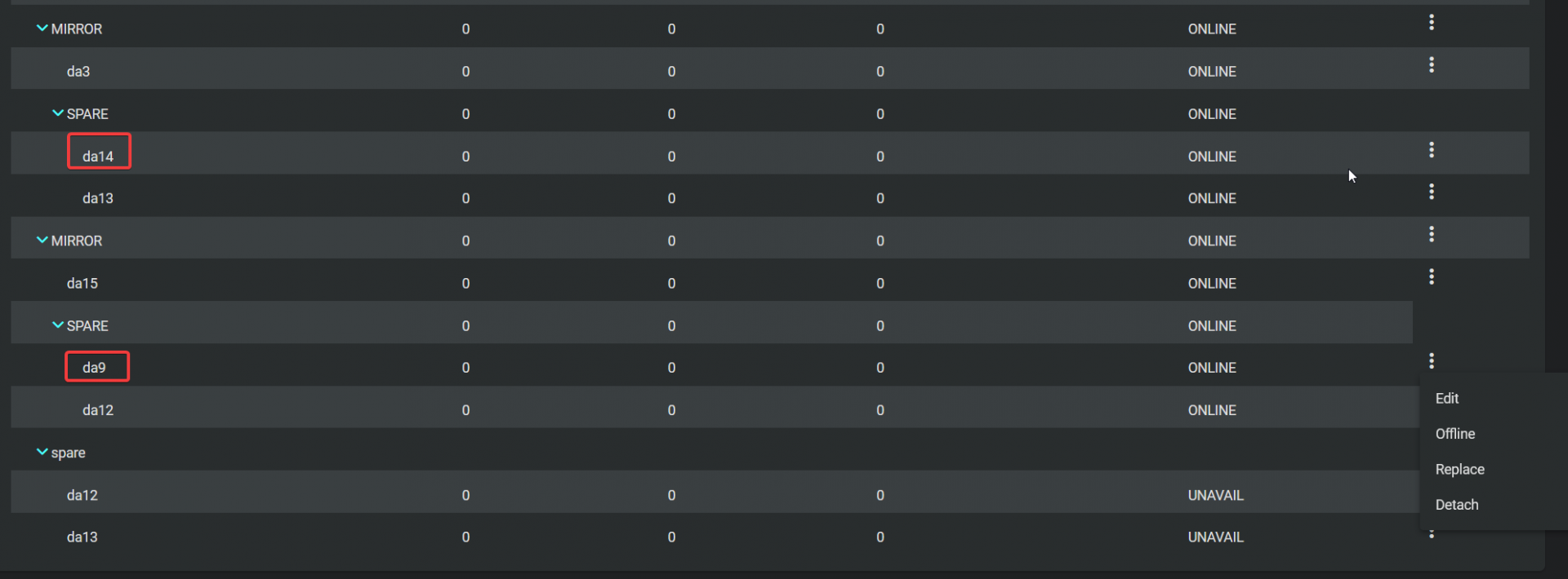

Ok so, here's the deal. I got two more replacement drives to replace one drive in each of the mirrors just in case.
For a sanity check, here was the mirrors and gptids.
  NAME                                              STATE     READ WRITE CKSUM
        PrimaryPool                                       ONLINE       0     0   0
          mirror-0                                        ONLINE       0     0   0
            gptid/d7476d46-32ca-11ec-b815-002590f52cc2    ONLINE       0     0   0
            gptid/d8d6aa36-32ca-11ec-b815-002590f52cc2    ONLINE       0     0   0
          mirror-1                                        ONLINE       0     0   0
            gptid/d9a6f5dc-32ca-11ec-b815-002590f52cc2    ONLINE       0     0   0
            gptid/db71bcb5-32ca-11ec-b815-002590f52cc2    ONLINE       0     0   0
          mirror-2                                        ONLINE       0     0   0
            gptid/d8b2f42f-32ca-11ec-b815-002590f52cc2    ONLINE       0     0   0
            gptid/d96847a9-32ca-11ec-b815-002590f52cc2    ONLINE       0     0   0
          mirror-3                                        ONLINE       0     0   0
            gptid/d9fb7757-32ca-11ec-b815-002590f52cc2    ONLINE       0     0   0
            gptid/da1e1121-32ca-11ec-b815-002590f52cc2    ONLINE       0     0   0
          mirror-4                                        ONLINE       0     0   0
            gptid/9fd0872d-8f64-11ec-8462-002590f52cc2    ONLINE       0     0   0
            gptid/9ff0f041-8f64-11ec-8462-002590f52cc2    ONLINE       0     0   0
          mirror-5                                        ONLINE       0     0   0
            gptid/14811777-1b6d-11ed-8423-ac1f6be66d76    ONLINE       0     0   0
            spare-1                                       ONLINE       0     0   0
              gptid/03daa071-505c-11ed-a9fe-ac1f6be66d76  ONLINE       0     0   0
              gptid/0d56b97d-1e91-11ed-a6aa-ac1f6be66d76  ONLINE       0     0   0
          mirror-6                                        ONLINE       0     0   0
            gptid/749a1891-1b5c-11ee-941f-ac1f6be66d76    ONLINE       0     0   0
              gptid/4710dd39-1b6d-11ed-8423-ac1f6be66d76  ONLINE       0     0   0
              gptid/0d48d4ab-1e91-11ed-a6aa-ac1f6be66d76  ONLINE       0     0   0
        spares
          gptid/0d48d4ab-1e91-11ed-a6aa-ac1f6be66d76      INUSE     currently in use
          gptid/0d56b97d-1e91-11ed-a6aa-ac1f6be66d76      INUSE     currently in use
So yes it looks like those are the two gptids for the spares that Johnny listed which makes sense.
It feels safer to do it this way, but correct me if I am wrong:
INSTEAD, do a replacement on the two drives that it is replacing in the pool?
Correct?
So in the Web GUI if I simply do a Pool Status > Replace Drive on da9 and da14, and pop in the new drives, the spares should detatch automatically after it resilvers successfully.
At least I am keeping the spares in tact. In case it had an actual reason to be attaching itself to replace those two drives.
Worst case scenario, the data isn't actually on the spares despite them being attached, and I take out 1 drive in each mirror that had the data on it, and replace it. And I simply put it back in and replace my new drives with that. Right?
And beyond that, now should I be concerned about the other few drives throwing SMART errors in your script @joeschmuck

The spares might not detach automatically, if so you will have to run the commands @Johnny Fartpants wrote. The plan seems solid, you just have to make sure to not replace the wrong drives... and even if you do, it's not the end of the world, you will have just wasted time.
The other path is to zpool clear PrimaryPool in order to try to see if the spares deatch automatically, then replace the suspect drives: this is riskier because it exposes you to a potential degraded vdev during resilver.
It would be these two to replace correct?
It appears to be so.

Just went ahead and replaced the two. It is resilvering now.
But now that I think about it, it seems it'd have made more sense to promote the two spares into that vdev, and then simply add the two new drives as new spares. No?
Not seeing an option for promoting them. But it'd reduce the wear on the spare drives because you are constantly cycling in new spares.
Too late now anyways, but would be good to know how for next time.

I've replaced drives before, and it usually takes nowhere near this amount of time... and it's estimating 10 DAYS?
Is this concerning?
Maybe not, since the estimation starts far from reality and gradually approaches it as the counter goes down (usually faster than real time if you watch it).

I figured both of these.
Although it was at about 7% 5 hours ago. And I remember it being at about 3% around 9 or 10am.
..Which is what kind of is scaring me. It just seems like way too long of a time.
Resilver priority is disabled as well. Would enabling it before I go to bed tonight, and setting it for bedtime hours help? Or just make things worse. The system isn't used a ton by then. At least actively, as I am the only user.
isopropyl
Jan 29, 2022
159
Is there any way to revert the resilver, and do this? It seems a bit safer.
Figuring it's too late though
9,703
isopropyl
Jan 29, 2022
159
They won't automatically detach.
I thought I recall them doing so in the past, but I guess I'm wrong.
Maybe I'm just wasting my time re-silvering new drives here then. :smile:
