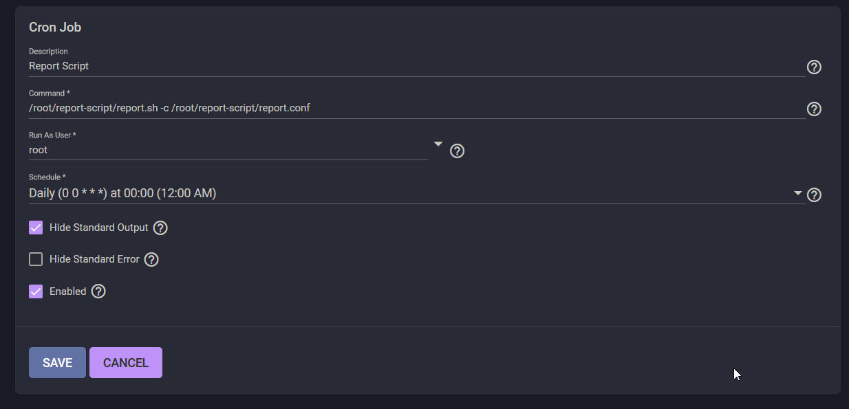

I had added the e-mail and changed default config from 1 to 0, then setup the cron. I click run now on the cron and that's the e-mail I get.
It created the report.conf file, I see it in the directory. E-mail address still is in there, and defaultconfig is still set to 0.
Can you post the command line in the cron task?
/root/report-script/report.sh -c /root/report-script/report.conf

@isopropyl if you are getting an email with Please edit the config file for your setup then your config file is not passing this check which likely means one of a few things: permission issues or a malformed file (the var name no longer matches). Try deleting your current config, generating a new one and using nano to edit the new config file in place and then try again.

I already tried it, even from scratch. However it could likely be my process order. Here's how I did it.
wget the raw git file
chmod +x report.sh
now I have the report.sh
vim report.sh
add my email, and change defaultconfig from 1 to 0, save
I see the same "please edit the config file for your setup" print in CLI
And like I said I get it to the e-mail so I know it is executing and sending me the e-mail at minimum, however not properly because that is all I see in the e-mail.
It's probably something stupid I'm doing that I'm missing here.

You don't edit the "report.sh" file. You'll edit the "report.conf" file that gets generated after the first run.
So you'll do this:
chmod +x report.sh
vim report.conf
So you'll do this:
chmod +x report.sh
vim report.conf
Yeah you're right, let me try

Ok I did it, however now I am not getting the e-mail.
If I just try to run the report script ./report.sh
it prints "please specify a config location, if none exist one will be created"
However I see the report.conf it already made when I ran /root/report-script/report.sh -c /root/report-script/report.conf and I edited the email and set defaultconfig to 0 and saved.
And yes I completely removed both files and started from scratch wget ing the file
dak180
Nov 22, 2017
310
Please try to follow the Getting Started directions as closely as possible.
I did like 3 times however I will look again
isopropyl
Jan 29, 2022
159
- I ran wget on the raw git file
- chmod +x on script
- placed in it's own folder right in root dir just called report-script/
- pwd = /root/report-script/
- went back to the cron job menu on TrueNAS
- hit run now
- I get the e-mail stating to edit the config file
- I go back into the dir and look, and I see the conf file is created
- I change defaultFile from 1 to 0, add my email, and enabled SAS. Saved.
- Went back to crong job menu on TrueNAS, hit run now
- No e-mail received anymore
It could be something stupid small I'm missing. Not sure what though, and not seeing it on the docs for the script.

And just to make sure: you have set up email notifications in the gui and tested that it will send an email to the address you listed in the config file?
Yes, and I get an e-mail's from the cron task and regular emails for scrubs and errors and stuff
TrueNAS: CronTask Run
/bin/sh: /root/report-script/report.sh: Permission denied (this was before I chmod +x it)
(this is when I ran it to create the .conf file, I then edited the .conf file and after saved, and then ran the script again and no e-mail since that)

I'm starting to wonder if the script isn't horking on this.
If you run the command "./report.sh -c report.conf" from the CLI within the directory, what's the output?
isopropyl
Jan 29, 2022
159
No output prints, it just hangs for a second.
Also why quote the da17 line? I don't think that has anything to do with why the script itself isn't working
dak180
Nov 22, 2017
310
It should just continue even if it cannot read anything.
Check the settings in the gui and make sure that sqlite3 /data/freenas-v1.db 'select em_fromemail from system_email;' gets you the same address as it sends from in the mails you are getting.
