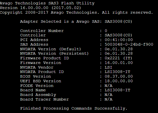

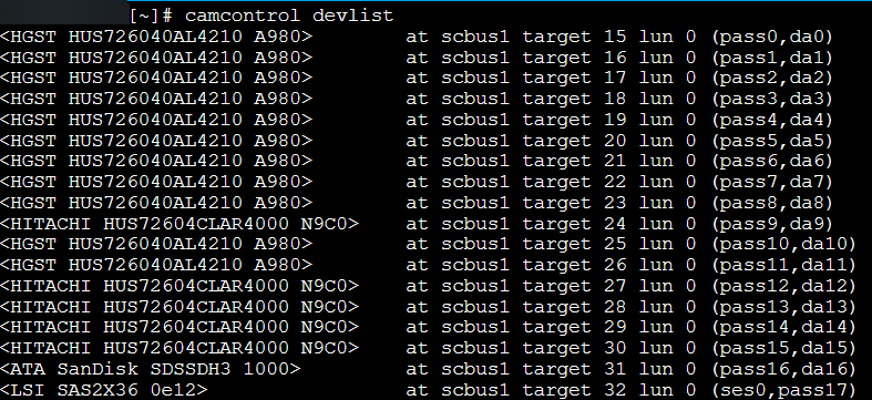

isopropyl
Jan 29, 2022
159
Two HBA controllers in IT mode ((Initiator Target) mode, the controller will not work in RAID mode, so that the operating system can see each disks individually).
They connect to the backplane. The backplane hosts the drives.
(Although technically I think I only have 1 HBA controller connected at the moment, making a solid 60% of my bays unusable. So it won't show two controllers connected. Unrelated to my hard drives, all the bays the hard drives are in are active and being used by the HBA that is connected.)
Output of sas3flash -list, maybe a camcontrol devlist as well?

Davvo
Jul 12, 2022
3,222
You have wrong firmware version. See the following resource.
Redcoat
Feb 18, 2014
2,925
You have listed 13 out of your 16 drives. Time to match serial numbers with drives and find out which ones are not functional (unless you've already done so)?
joeschmuck
Old Man
May 28, 2011
10,996
There are 16 drives in the system. It appears that da12 and da13 are the spares and are being used to replace da9 and da14 respectively, if I'm reading the output correctly (I added the device idents and I've never paid attention to an output that had spares active). This would be drives K4K0BBJB and K4J3EXNB (I have the full multi_report output). But what I do not understand is it looks like the Spares were manually assigned, the drive it replaced is not "UNAVAIL" and the mirrors are not "DEGRADED". As far as I can tell, you can manually detach the spares HOWEVER, WAIT until someone tells you that it's safe. Don't do it because I mentioned it, I don't consider myself the expert on this topic.
