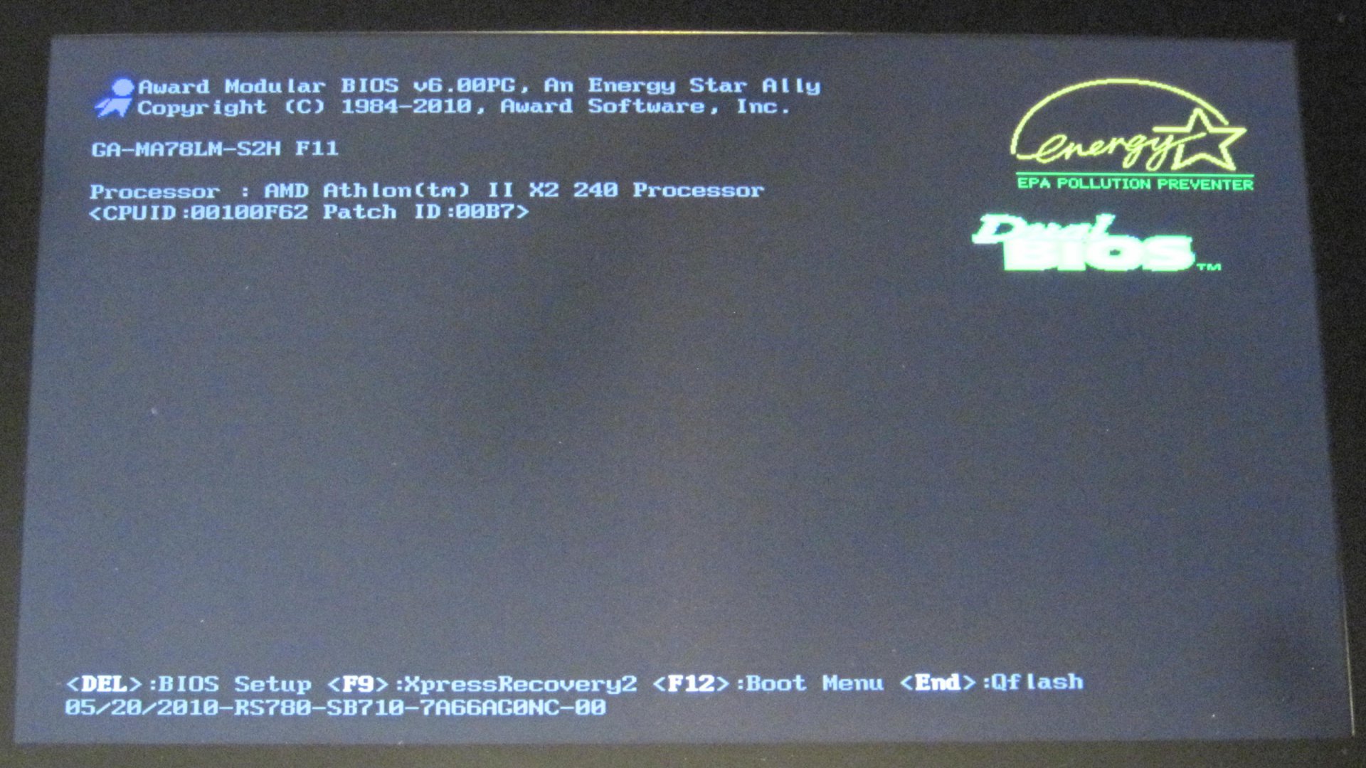

- About 4 seconds later, the display turns on using the onboard VGA output.
- And here it shows same as the posted picture.

- I start the computer without the USB key.
- System pass BIOS POST.
- Before it reaches the time where the system select the boot drive (if one is available. In more cases I have tried with disk and without ones).
-I insert (shove in ) the USB in one of the USB port and the system freezes.

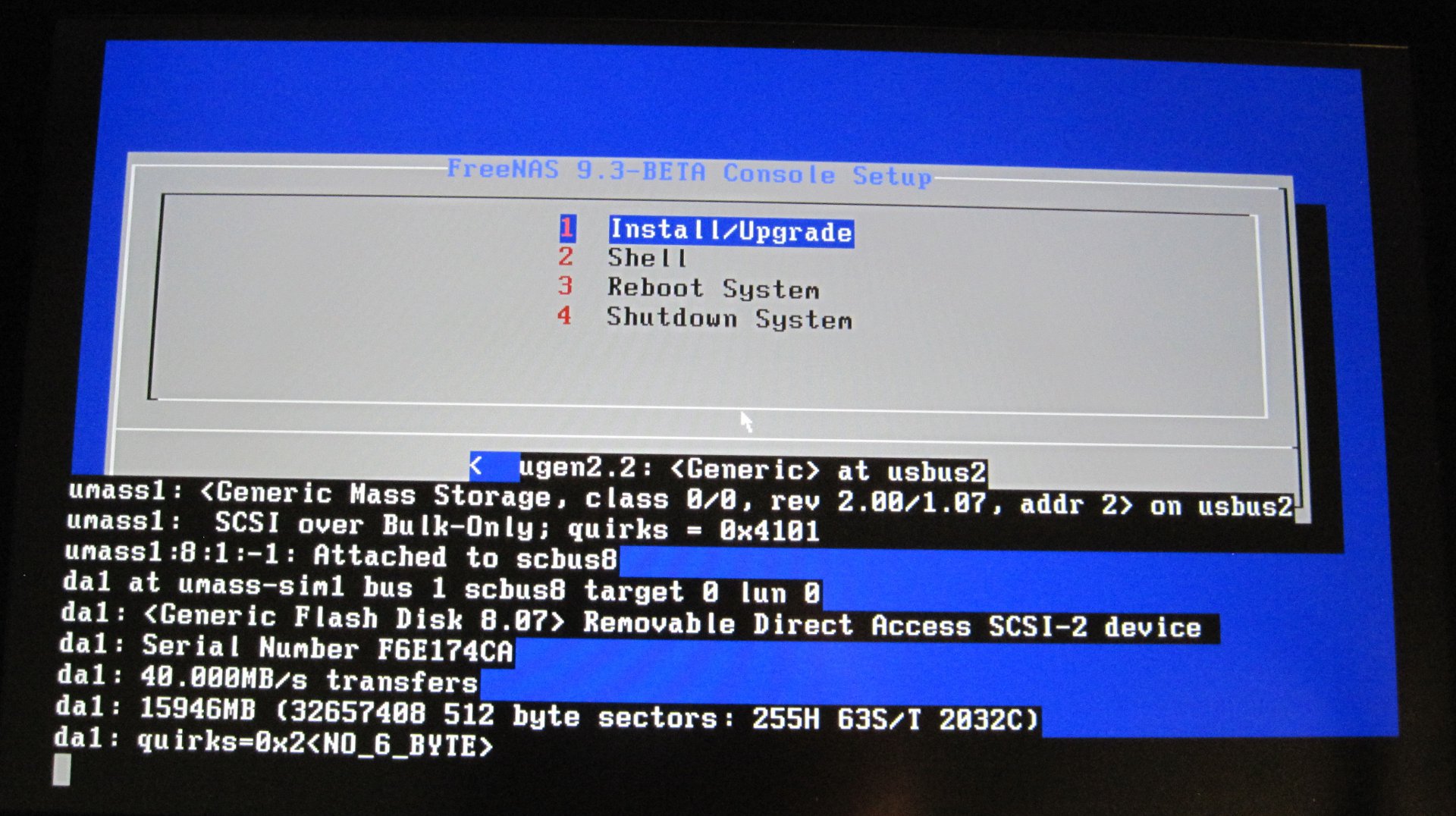

- When the display shows the FREENAS 9.3 BETA Console Setup, 4 options are presented: 1, 2, 3 and 4.
- I insert the USB key with the FREENAS 9.3 beta used in case 1, 2, 3 and 4.
- System display a bunch of information, but doesn't freeze.
