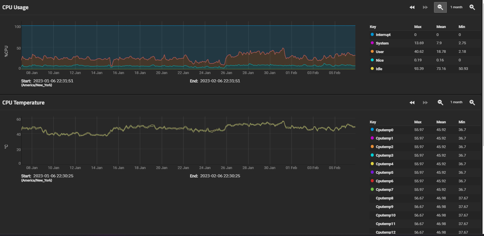

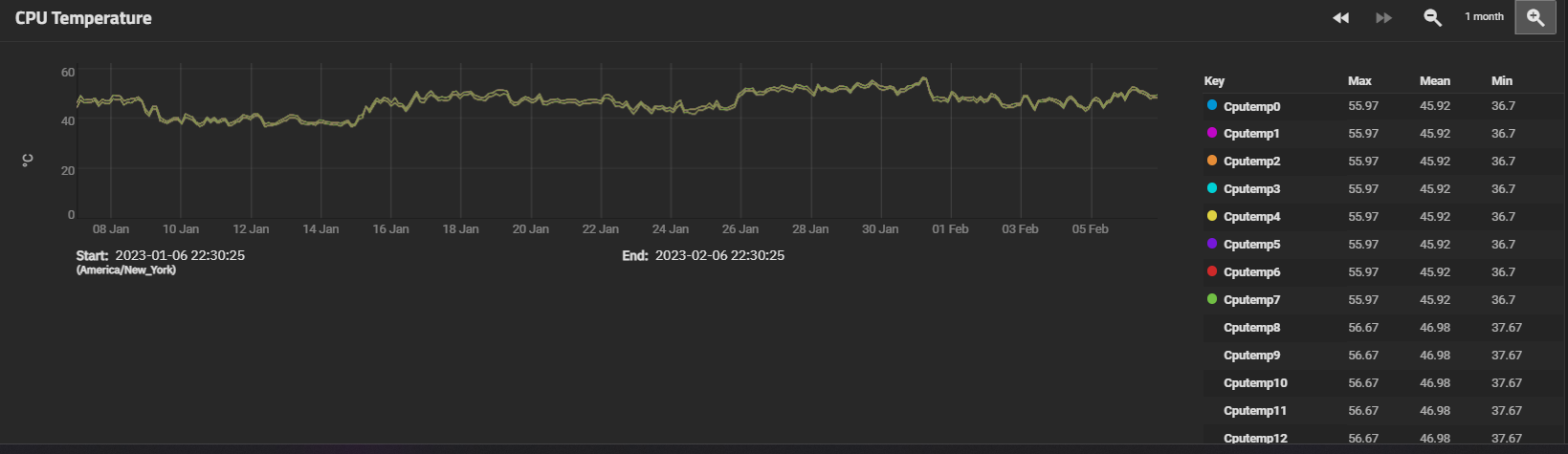

I have a 7282 in an older Fractal Define R3 with Noctua IPPC fans and a Noctua NH-U12S. My IT closet ranges from 70-80 degrees Fahrenheit, and my CPU temps are as follows:
It stays under 60 degrees no matter what I am doing, CPU load is less than about 50% on average.
I wouldn't bother with water cooling. Just extra thing to be worried about with a pump failure. Less moving parts is better. Obviously you are building a rather unique setup, so I have no idea what to expect.
