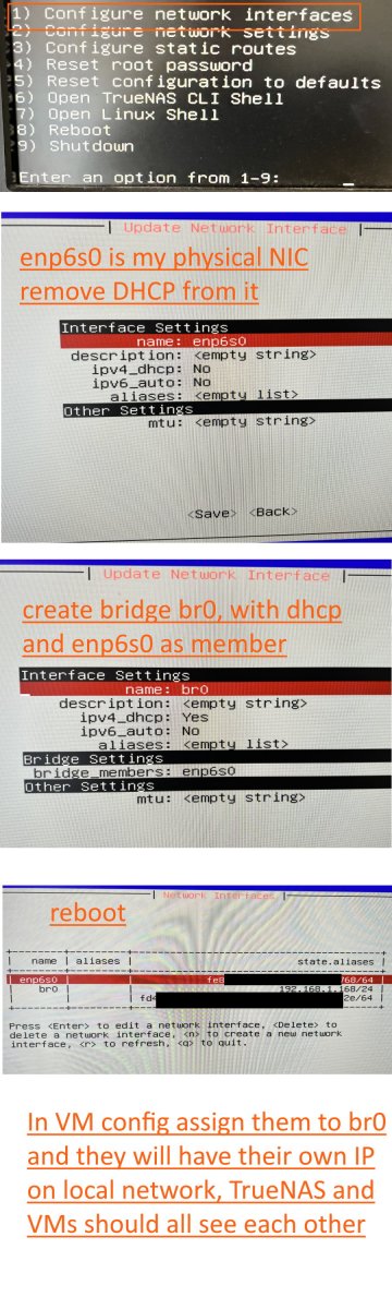

I was able to get the bridge for VMs working when using physical keyboard+monitor setup and their onscreen menu.
For anyone else having the same problem I will just post my steps here:

Thank you for posting the images @urza.
I'm attempting to follow along, but in my netcli there's no white+blue text UI, when I select Configure Interfaces, it just asks a couple quests about the enp0 device and goes back to the menu. No bridge options listed.
I'm using Truenas Scale 22.02.1, what version are you on?
I am on the same version as you. I was doing it with physically attached monitor and keyboard to my truenas box.

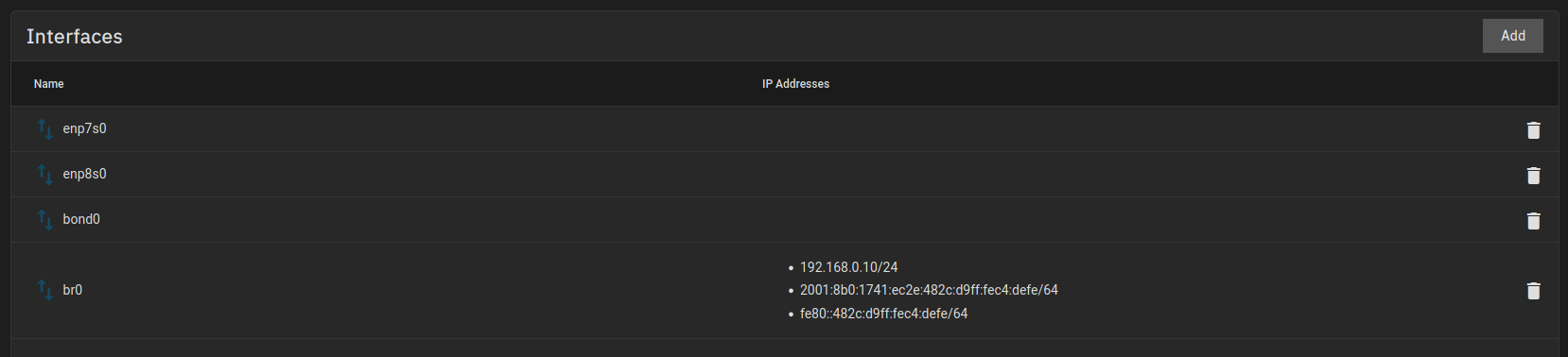

Just wanted to add that I got this working as well. I have two NICs configured in an LACP bond. I then added the bond to the bridge. I did have to reboot for the configuration to apply itself properly for whatever reason. I made the changes from the CLI setup screen of the server rather than the web GUI.
enp7s0 and enp8s0 both members of bond0 which in turn is a member of br0. Desired IP is applied to the br0 interface.
You just inspire me and made my life easier!
I just got this scenario worked as well, with two NICs and a bridge working with LACP on a Ubiquiti Unifi Switch Pro 24 PoE. Next challenge is to segment everything with VLANs but I will let this to another day
