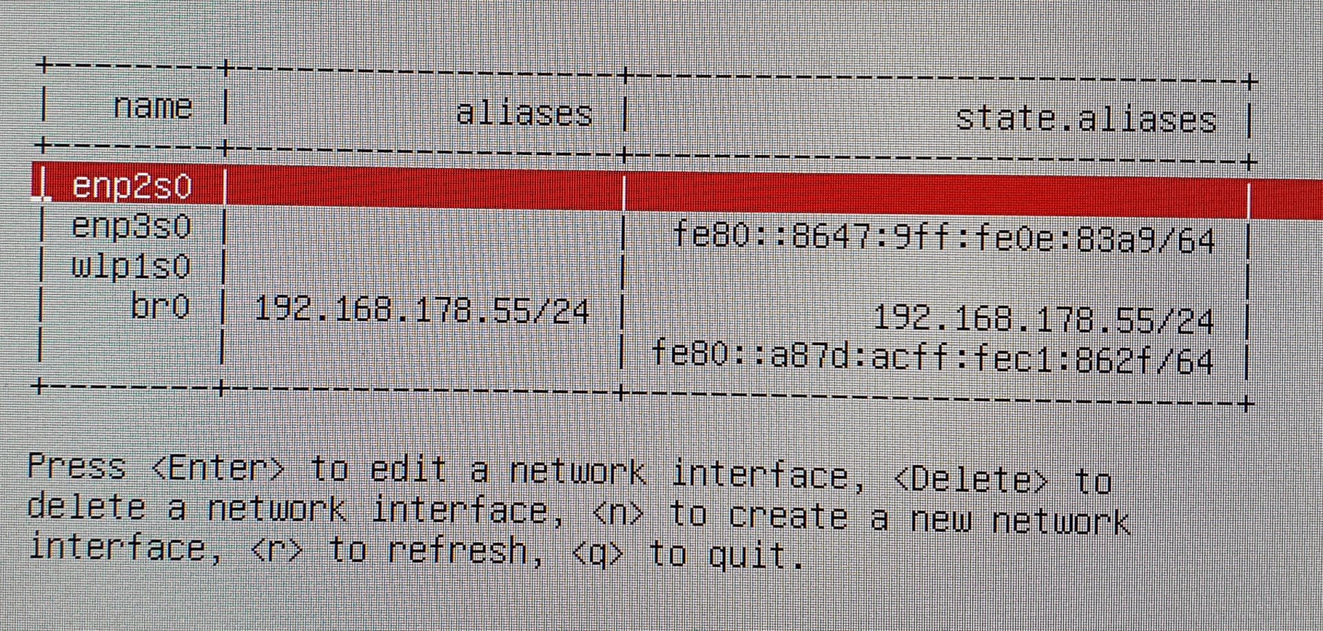

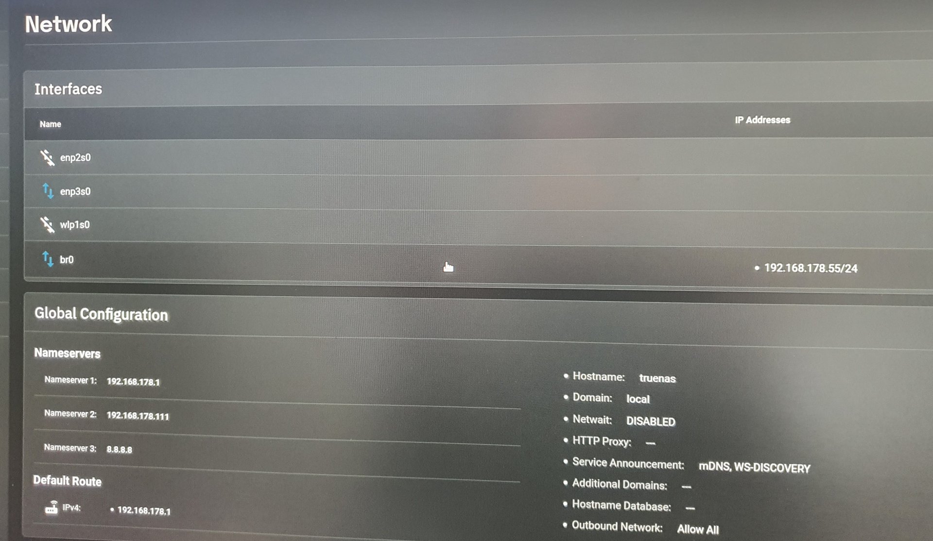

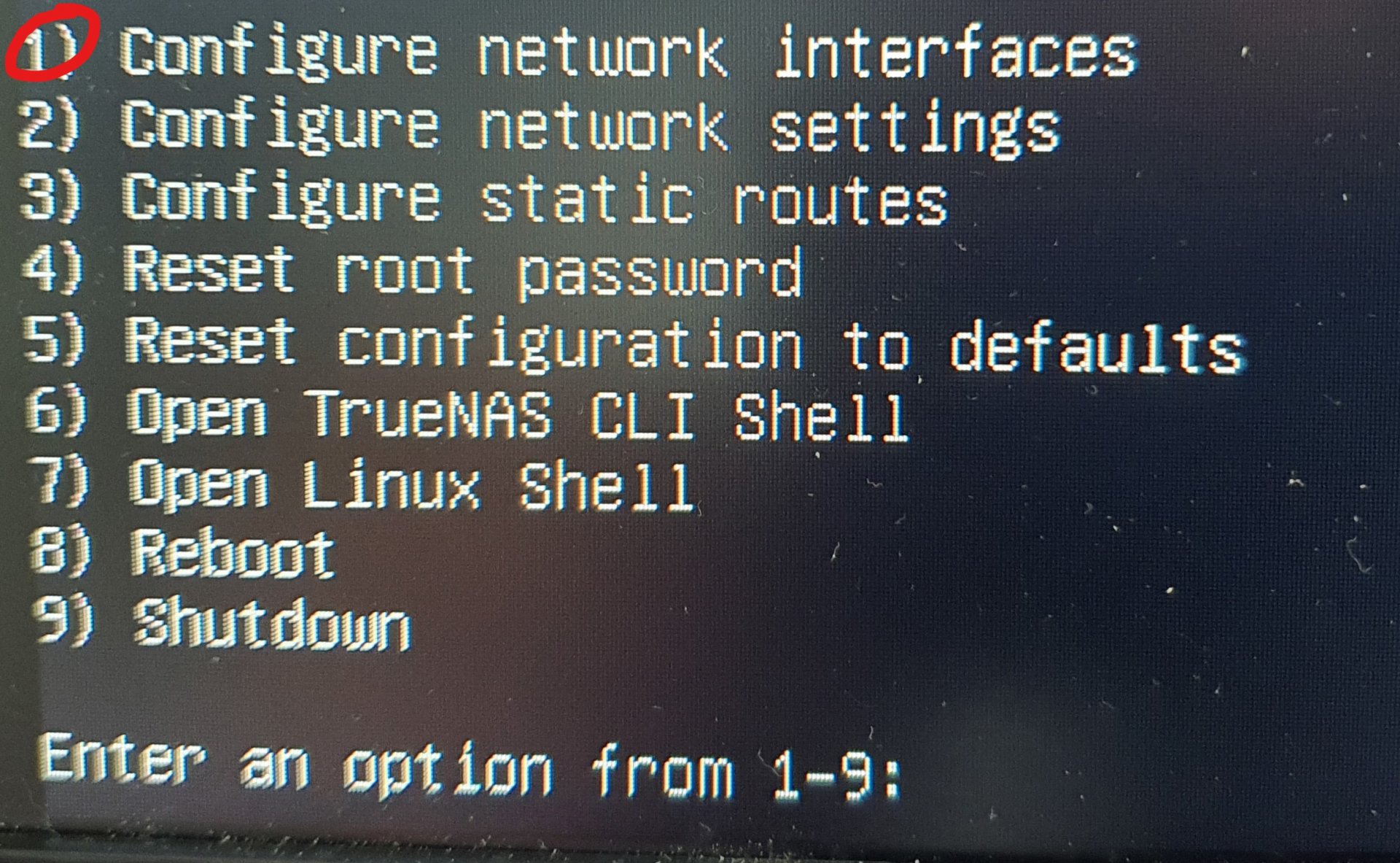

olepinguin
Apr 10, 2022
10
Hi, could anyone please elaborate on the steps how to do this in the CLI interface (I've no idea what I'm doing there). I have a bond0 interface with 6 members which is bound to 192.168.1.181 and then I got a vm that is also using bond0 which makes everything works everywhere apart from the vm and truenas not being able to see each other. So far everything I tried in ui or cli just kills network until it rolls back.
So I gather I have to make new interface br0, add the bond0 to it, remove the ip from bond0 and add the ip to br0, then attach vm to br0. Trying to do that in ui I run into same issues as in above posts and I can't figure the commands in the CLI.
Thanks for any suggestions.
as mentioned you need to go to the machine where TN is running on. NOT CLI (no ssh or shell on http GUI)
After reboot the screen will show theese opion (or erros) - you will see the following options
after entering 1 for first option you will see the NW config, where you need to create / change the bridge (br0 in my case) that should be used for your VM. Assign the host IP and ensure the network adapter of the host (emp3s0 in my case) dosn't have assigned the same IP
at the end of the day, if you switch back to your server GUI within the UI ist should be looks like that
