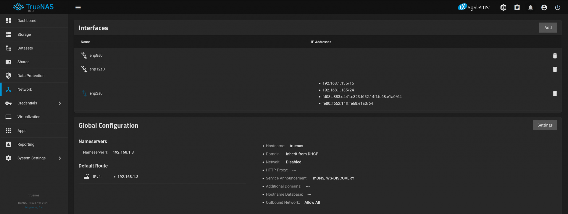

After using TrueNAS Core for many years, I finally swapped over to TrueNAS Scale Bluefin a couple of weeks ago. Since then, I've been having network connectivity issues.
My gateway is IPV4 only at 192.168.1.3/24
Running `ip route` shows the routes look sane:
root@truenas[~]# ip r
default via 192.168.1.3 dev enp3s0 proto static
10.134.0.0/24 dev wg0 proto kernel scope link src 10.134.0.1
172.16.0.0/16 dev kube-bridge proto kernel scope link src 172.16.0.1
192.168.1.0/24 dev enp3s0 proto kernel scope link src 192.168.1.135

This issue affects update checking and apps that are present on the system as well.
