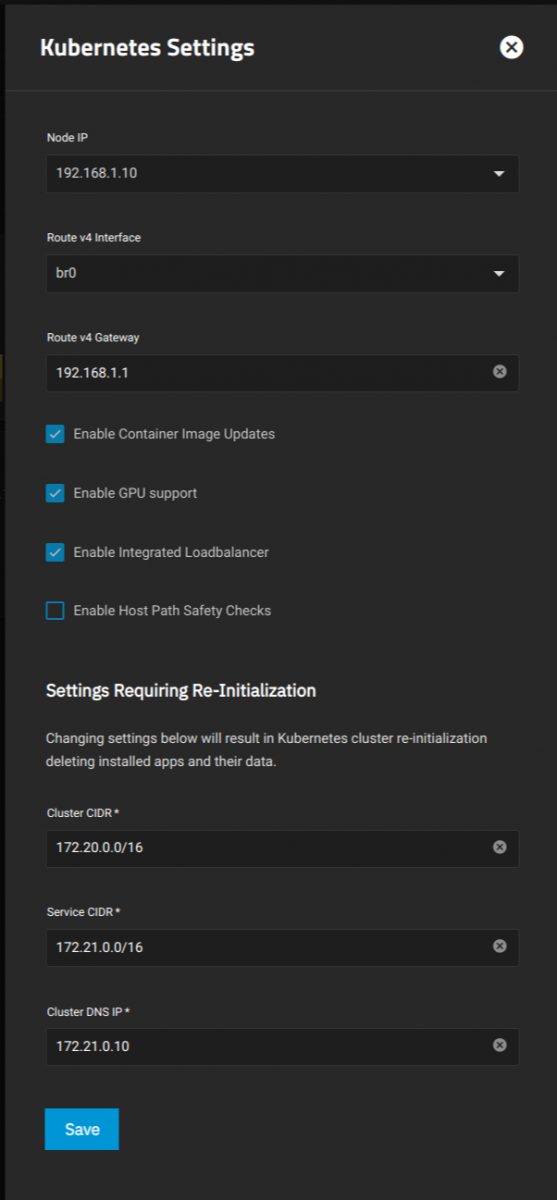

I have. I had PBR on my router which grabbed traffic from the NAS and forwarded it to a VPN connection.
One problem, as far as I can tell, is that the kube-router forwards all traffic out of the container network to the default router which is left to redirect the traffic back into the LAN if thats where it was destined. This means that if like me you were preventing the redirect (or rather sending the traffic elsewhere before the redirect) then traffic will never reach the LAN. It also means that the router has to deal with all traffic egressing from the containers whether is going to the other side of the router (which is correct) or the LAN (which isn't)
IX have declined to fix this.

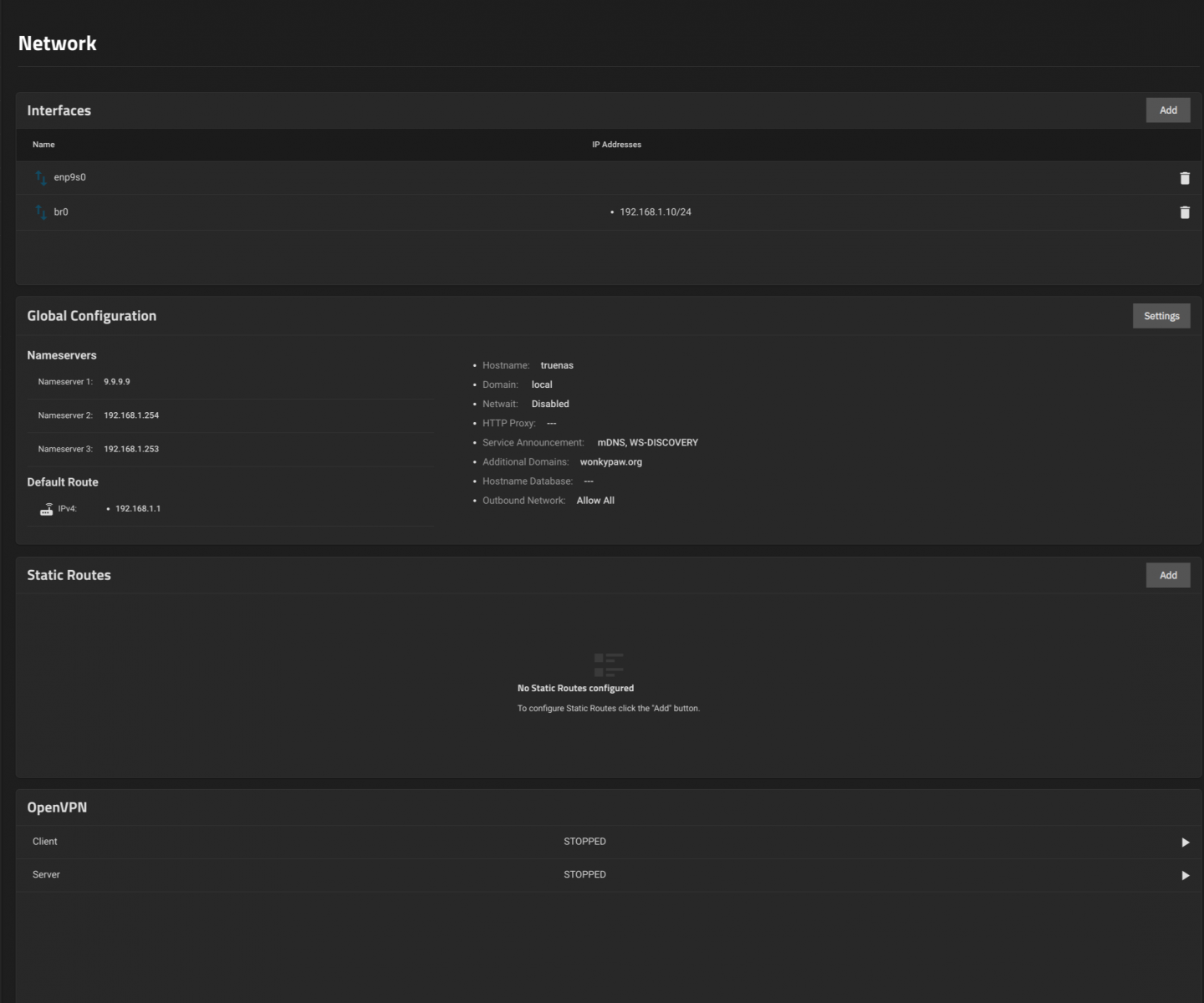

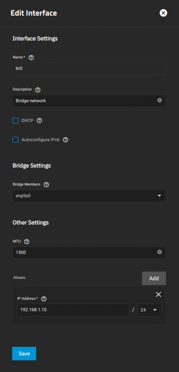

I don't know what really happened with my NAS, when I posted this post I wasn't able to ping anything in my local network, other than my Gateway and my scale host IP. Today, I saw your post, so I went back and checked to see if the issue is the same. Now, I am able to ping all the machines from my network.
The only thing which I changed recently was by creating a new bridge for my second ethernet card and configuring k3s to use this ethernet card instead of my primary card.
At the time when I did this change, I wasn't able to ping anything.
I am very confused, you can see the ping message in the first post, at that time nothing worked.

I change the Cluster/Service and Gateway CIDR IPs from 172.16.0.0/16 and 172.17.0.0/16 network to 172.20.0.0/16 and 172.21.0.0/16. I thought this might bounce the network stack for k3s and make a clean install. The issue is still the same.
Before I answer your questions, I never had issues with Scale until I upgraded to the latest version. My Scale apps, like emby, were able to connect to my internal network fine.
What is the router? Make/Model/OS?
The router is a HUAWEI 5G CPE Pro with basic DHCP network configuration. No advanced routing configuration is set in this router. I can't even do that, to be honest :)
Other thoughts:

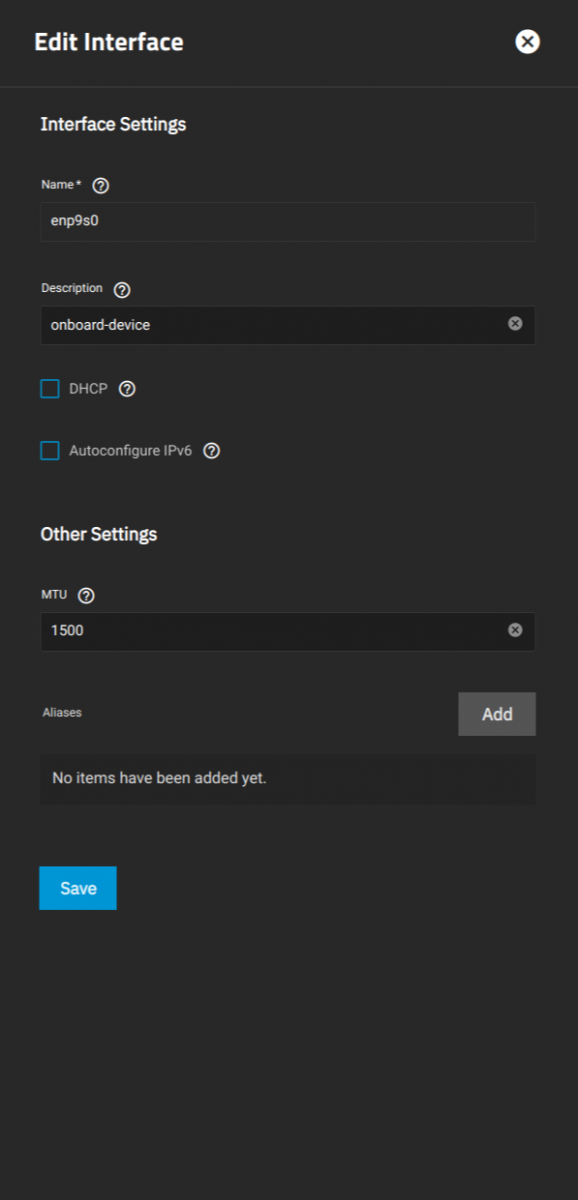

I used to have a second ethernet card connected via USB 3, the card was configured in bridge mode, using DHCP (don't judge me pls, I tried to assign a static IP but the UI didn't let me), anyway. This card is no longer connected in the NAS, I removed it, I thought at first the whole problem is because the k3s is using this card and might encounter some issues with the network. Eventually, I moved the k3s cluster and VMs to my main ethernet card which is configured in bridge mode too.
Your LAN - 192.168.1.0/24 - My Local network subnet
Gateway - 192.168.1.1 - Gateway configured in the NAS, basically, my router IP.
DNS - 192.168.1.254 & 192.168.1.253 - Both virtual appliances, 254 located in the NAS, 253 located on a different VM in a different machine.
Scale IP - 192.168.1.10/24 - The IP of scale host.
What is also strange thou, after I removed the USB network card, and rebooted my NAS everything started to work well. I was able to ping my other devices or resolve the DNS. However, last night I decided to move my NAS to a different location in the house, and when I brought the NAS back, the issue reappeared. I couldn't start some apps (it required resolving the DNS).
I have a basic TP-link switch TL-SG2008. Just because I change the NAS to use a different network cable and different port the cluster broke? This doesn't make any sense at all, as the host is still not affected.
This is the reason why I configured now the NAS with 9.9.9.9 DNS.
As you can see from the screenshots I have a very basic configuration. No extra routing, VPNs, etc configured.
Thanks for your help, and if I need to send you anything else let me know.

OK - Comment 1
I do know that for a VM (DNS on NAS) to talk to the NAS - it has to be on a bridge - as you have done. And as far as I can tell correctly. Its done in the same manner as mine - which works despite the crappy routing as the router does redirect back to the LAN. I assume that the opposite applies for the NAS to talk to a VM there has to be a bridge. However as stated this is done correctly (any one else have a look - I don't see an issue)
