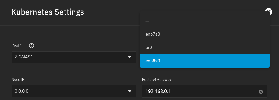

You can create an ubuntu vm and install WireGuard in that (I used the pivpn script - https://pivpn.io/ - which makes it all very easy). However, there is a problem so far in Scale that is not in Core that means the vm and host network need to use a bridge to be accessible to each other. Without this you cannot access the host ouside the LAN using WireGuard. This, so far, has messed up my Apps (Apps - Settings - Advanced Settings - Kubernetes Settings) access to the internet. The apps catalog won't update / download. I have tried various options within this dialog box (for the Route v4 Interface using the bridge / original interface / second NIC), all to no avail. See attached. Strangely, a previous-to-this-network-change installation of Transmission still works - i.e. still has internet access - so I'm at a loss to explain that.
Ziggy
Oct 7, 2015
157
I did eventually resolve this by choosing the bridge, the host ip in node ip, and the router's ip in gateway.
