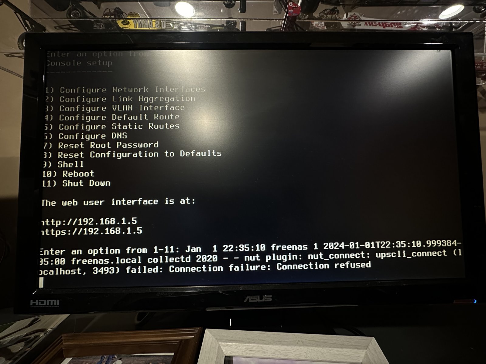

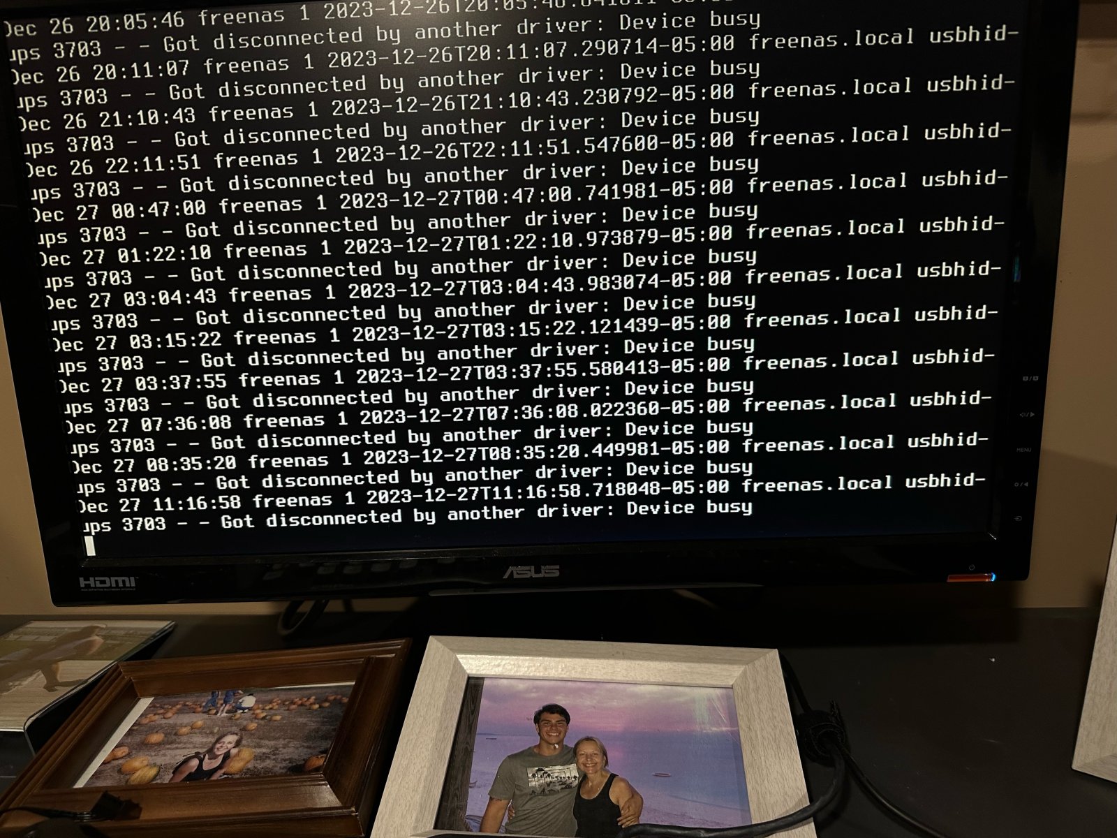

I just realized my USB cable from my CyberPower 1500AVR was disconnected. I am running TRUENAS CORE 13U-6.1.
I am getting this error after hooking cable up and configuring the UPS services. I tried different drivers but it seems usbhid is he one for Cyberpower.

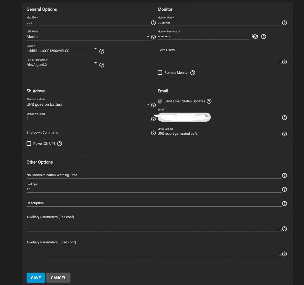

My config.

Updated. When I issue upsc ups I get this:
RESULT IN SYSTEM FAILURE.

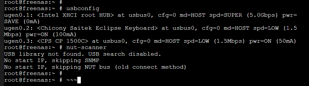

Jun 2, 2019
590
All CP models use the usbhid-ups driver. Any will do.
When it was unplugged and re-plugged it likely got assigned a different USB bus ID. Just set the port to auto and it will automatically connect.
Type the following commands:
usbconfig
nut-scanner

Doesnt seem to work. I also did set the port to Auto. Still getting error

Jun 2, 2019
590
/dev/ugen0.2 appears to be a KB
/dev/ugen0.3 is your CP UPS
Try stopping and restarting the UPS service, or reboot TrueNAS.

I just forced it to .3 port, stopped and started service. Lets see what happens. Thanks!

Spoke to soon. doing it not as often .. WTF

Let's start all over again... In the Driver section, use : usbhid-ups$AE550
For the port: auto
For Shutdown Timer: 120 as I don't think you really want 4 whole seconds. If it's a quick power drop, let the system run. Or change to 60 seconds.
I would also check the box for Power Off UPS to save the batteries from discharging and shortening life.
Click on Save
Ensure your USP service is still running. Take note of the time and see if you have any further error messages. If so, report those. Now I need to ensure I don't have the same issue.
bent98
Jul 21, 2017
171
For the port: auto
Click on Save
Done. Ill report back. I thought time was in minutes. Good catch.

If you want to test if your UPS and computer are talking correctly, just unplug your UPS, you will find out and make sure the computer properly shuts down. It is best in a controlled environment. When I first go into FreeNAS, I tested run times on my UPS and system, I did everything I could think of. I needed to know for myself that it would work as I expected.

So it’s still doing it based on your settings
What do you recommend ?

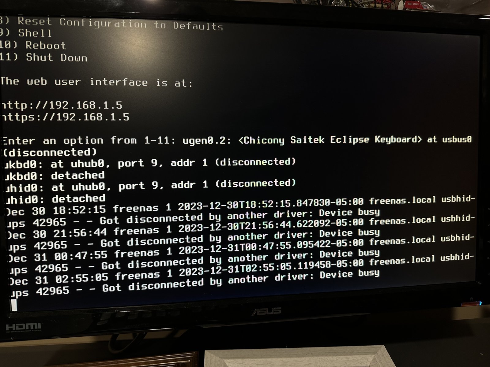

Do you have any USB ports in use besides the UPS connection? If yes, disconnect those if you can, such as keyboard and mouse. See if that helps.
Let's say disconnecting those USB devices work and the messages stop coming. I'd reboot and monitor for a while to make sure those messages are clear.
If you are still doing well, you can plug a single USB item back in. Wait to see if the problem returns. Rinse and Repeat and hopefully one item will be the problem.
Now let's say you plug in a USB keyboard and the problem starts up again... Move the keyboard to a different USB port. Keep track of what you are doing. If you can solve the problem by reconfiguring the USB port assignment then great.
So if that fails, move the UPS USB cable to another port (all ports if needed). You see what I'm doing, we are reconfiguring the hardware in small steps and the goal here is to first identify the exact problem. Is it the USB device or the USB port causing the error, or none of the above.
That is all I can think of for now. If it's not a USB issue then I'm not sure what else it could be.
You could try to look in the log files for the time periods listed on your console. To email yourself a copy of these logs, do the following in the Shell:

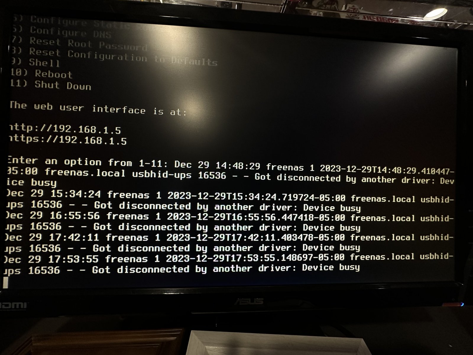

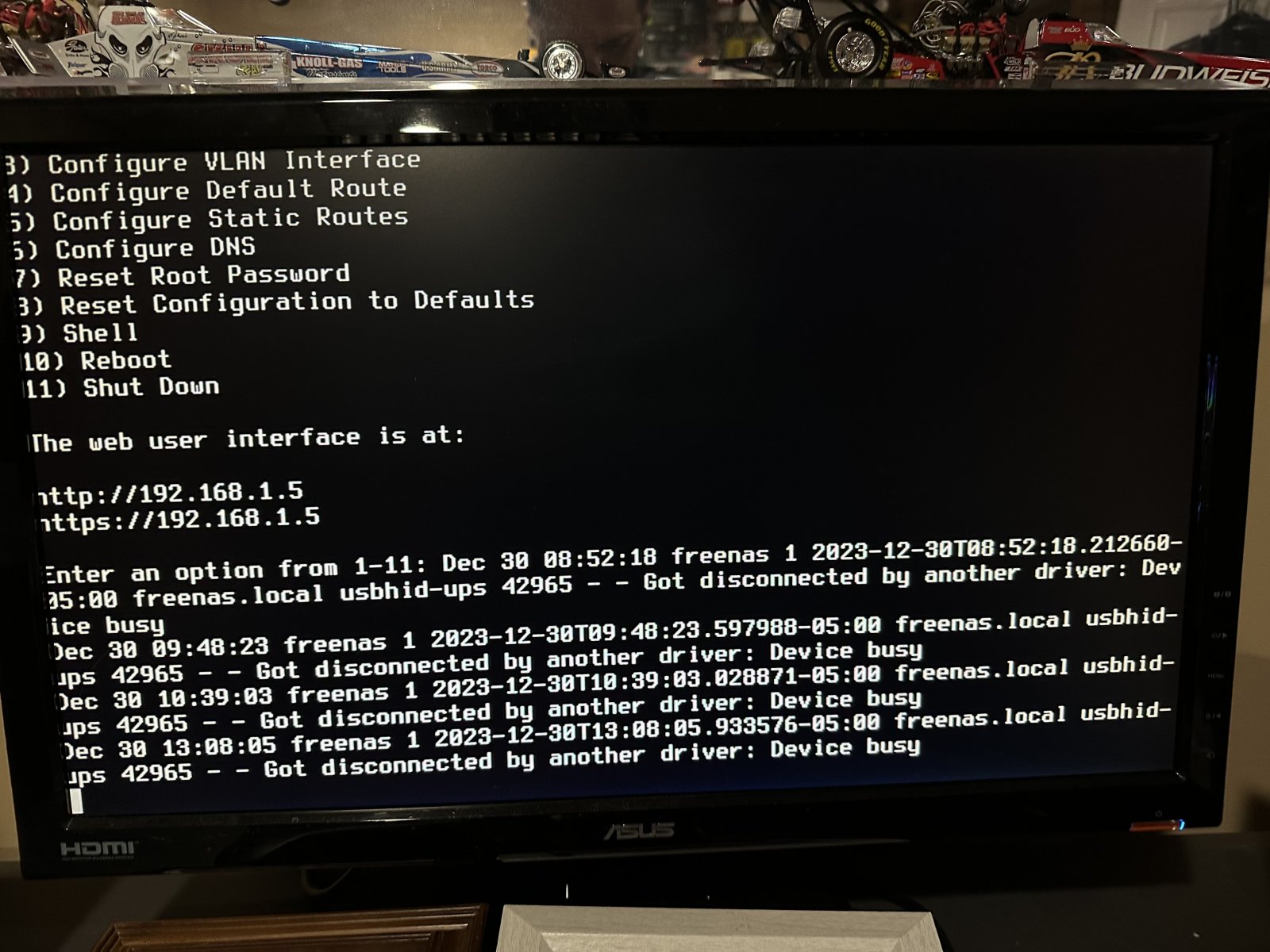

So the only other USB device plugged in is a keyboard. Screenshot shows the time when I disconnected keyboard and then the ensuing errors. it looks like it happens every 2-3 hours.

 Dec 28 00:00:00 freenas newsyslog[5879]: logfile turned over due to size>200K
Dec 28 00:00:00 freenas syslog-ng[2140]: Configuration reload request received, reloading configuration;
Dec 28 00:00:00 freenas syslog-ng[2140]: Configuration reload finished;
Dec 28 00:22:46 freenas 1 2023-12-28T00:22:46.018369-05:00 freenas.local usbhid-ups 1434 - - Got disconnected by another driver: Device busy
Dec 28 00:26:31 freenas 1 2023-12-28T00:26:31.730029-05:00 freenas.local usbhid-ups 1434 - - Got disconnected by another driver: Device busy
Dec 28 00:43:29 freenas 1 2023-12-28T00:43:29.109890-05:00 freenas.local usbhid-ups 1434 - - Got disconnected by another driver: Device busy
Dec 28 00:46:09 freenas 1 2023-12-28T00:46:09.413860-05:00 freenas.local usbhid-ups 1434 - - Got disconnected by another driver: Device busy
Dec 28 01:19:02 freenas 1 2023-12-28T01:19:02.922343-05:00 freenas.local usbhid-ups 1434 - - Got disconnected by another driver: Device busy
Dec 28 04:38:50 freenas 1 2023-12-28T04:38:50.993203-05:00 freenas.local usbhid-ups 1434 - - Got disconnected by another driver: Device busy
Dec 28 05:41:17 freenas 1 2023-12-28T05:41:17.386471-05:00 freenas.local usbhid-ups 1434 - - Got disconnected by another driver: Device busy
Dec 28 05:53:08 freenas 1 2023-12-28T05:53:08.972118-05:00 freenas.local usbhid-ups 1434 - - Got disconnected by another driver: Device busy
Dec 28 07:43:35 freenas 1 2023-12-28T07:43:35.806378-05:00 freenas.local usbhid-ups 1434 - - Got disconnected by another driver: Device busy
Dec 28 09:16:07 freenas 1 2023-12-28T09:16:07.033823-05:00 freenas.local usbhid-ups 1434 - - Got disconnected by another driver: Device busy
Dec 28 09:45:28 freenas 1 2023-12-28T09:45:28.326202-05:00 freenas.local upsmon 1444 - - upsmon parent: read
Dec 28 09:45:28 freenas 1 2023-12-28T09:45:28.343879-05:00 freenas.local upsd 1436 - - mainloop: Interrupted system call
Dec 28 09:45:59 freenas 1 2023-12-28T09:45:59.165343-05:00 freenas.local usbhid-ups 12292 - - Got disconnected by another driver: Device busy
Dec 28 10:01:14 freenas 1 2023-12-28T10:01:14.568832-05:00 freenas.local usbhid-ups 12292 - - Got disconnected by another driver: Device busy
Dec 28 10:01:49 freenas 1 2023-12-28T10:01:49.144021-05:00 freenas.local usbhid-ups 12292 - - Got disconnected by another driver: Device busy
Dec 28 11:49:14 freenas 1 2023-12-28T11:49:14.560372-05:00 freenas.local usbhid-ups 12292 - - Got disconnected by another driver: Device busy
Dec 28 11:51:22 freenas 1 2023-12-28T11:51:22.906746-05:00 freenas.local usbhid-ups 12292 - - Got disconnected by another driver: Device busy
Dec 28 15:46:43 freenas 1 2023-12-28T15:46:43.481540-05:00 freenas.local upsmon 12303 - - upsmon parent: read
Dec 28 15:46:43 freenas 1 2023-12-28T15:46:43.499637-05:00 freenas.local upsd 12294 - - mainloop: Interrupted system call
Dec 28 15:46:51 freenas 1 2023-12-28T15:46:51.985728-05:00 freenas.local upsmon 16374 - - upsmon parent: read
Dec 28 15:46:52 freenas 1 2023-12-28T15:46:52.004581-05:00 freenas.local upsd 16365 - - mainloop: Interrupted system call
Dec 28 15:46:52 freenas 1 2023-12-28T15:46:52.295960-05:00 freenas.local collectd 16522 - - nut plugin: nut_connect: upscli_connect (localhost, 3493) failed: Connection failure: Connection refused
Dec 28 19:32:10 freenas 1 2023-12-28T19:32:10.728264-05:00 freenas.local usbhid-ups 16536 - - Got disconnected by another driver: Device busy
Dec 28 20:36:42 freenas 1 2023-12-28T20:36:42.241636-05:00 freenas.local usbhid-ups 16536 - - Got disconnected by another driver: Device busy
Dec 28 20:44:07 freenas 1 2023-12-28T20:44:07.302246-05:00 freenas.local usbhid-ups 16536 - - Got disconnected by another driver: Device busy
Dec 28 21:42:44 freenas 1 2023-12-28T21:42:44.231599-05:00 freenas.local usbhid-ups 16536 - - Got disconnected by another driver: Device busy
Dec 29 00:00:00 freenas syslog-ng[2140]: Configuration reload request received, reloading configuration;
Dec 29 00:00:00 freenas syslog-ng[2140]: Configuration reload finished;
Dec 29 02:31:34 freenas 1 2023-12-29T02:31:34.567315-05:00 freenas.local usbhid-ups 16536 - - Got disconnected by another driver: Device busy
Dec 29 08:16:55 freenas 1 2023-12-29T08:16:55.523734-05:00 freenas.local usbhid-ups 16536 - - Got disconnected by another driver: Device busy
Dec 29 08:57:30 freenas 1 2023-12-29T08:57:30.483291-05:00 freenas.local usbhid-ups 16536 - - Got disconnected by another driver: Device busy
Dec 29 14:48:29 freenas 1 2023-12-29T14:48:29.410447-05:00 freenas.local usbhid-ups 16536 - - Got disconnected by another driver: Device busy
Dec 29 15:34:24 freenas 1 2023-12-29T15:34:24.719724-05:00 freenas.local usbhid-ups 16536 - - Got disconnected by another driver: Device busy
Dec 29 16:55:56 freenas 1 2023-12-29T16:55:56.447418-05:00 freenas.local usbhid-ups 16536 - - Got disconnected by another driver: Device busy
Dec 29 17:42:11 freenas 1 2023-12-29T17:42:11.403478-05:00 freenas.local usbhid-ups 16536 - - Got disconnected by another driver: Device busy
Dec 29 17:53:55 freenas 1 2023-12-29T17:53:55.148697-05:00 freenas.local usbhid-ups 16536 - - Got disconnected by another driver: Device busy
Dec 30 00:00:00 freenas syslog-ng[2140]: Configuration reload request received, reloading configuration;
Dec 30 00:00:00 freenas syslog-ng[2140]: Configuration reload finished;
Dec 30 01:12:04 freenas 1 2023-12-30T01:12:04.972061-05:00 freenas.local usbhid-ups 16536 - - Got disconnected by another driver: Device busy
Dec 30 01:36:40 freenas 1 2023-12-30T01:36:40.048944-05:00 freenas.local usbhid-ups 16536 - - Got disconnected by another driver: Device busy
Dec 30 07:41:53 freenas 1 2023-12-30T07:41:53.449266-05:00 freenas.local usbhid-ups 16536 - - Got disconnected by another driver: Device busy
Dec 30 08:35:52 freenas 1 2023-12-30T08:35:52.191158-05:00 freenas.local upsmon 16546 - - upsmon parent: read
Dec 30 08:35:52 freenas 1 2023-12-30T08:35:52.210863-05:00 freenas.local upsd 16538 - - mainloop: Interrupted system call
Dec 30 08:35:52 freenas 1 2023-12-30T08:35:52.516301-05:00 freenas.local collectd 42774 - - nut plugin: nut_connect: upscli_connect (localhost, 3493) failed: Connection failure: Connection refused
Dec 30 08:35:57 freenas 1 2023-12-30T08:35:57.311358-05:00 freenas.local root 42793 - - /usr/local/etc/rc.d/nut: WARNING: failed precmd routine for nut
Dec 30 08:35:57 freenas 1 2023-12-30T08:35:57.336523-05:00 freenas.local upsmon 42802 - - UPS [ups@localhost:3493]: connect failed: Connection failure: Connection refused
Dec 30 08:35:57 freenas 1 2023-12-30T08:35:57.336537-05:00 freenas.local upsmon 42802 - - Communications with UPS ups@localhost:3493 lost
Dec 30 08:35:57 freenas 1 2023-12-30T08:35:57.877354-05:00 freenas.local collectd 42871 - - nut plugin: nut_connect: upscli_connect (localhost, 3493) failed: Connection failure: Connection refused
Dec 30 08:36:02 freenas 1 2023-12-30T08:36:02.366934-05:00 freenas.local upsmon 42802 - - UPS [ups@localhost:3493]: connect failed: Connection failure: Connection refused
Dec 30 08:36:02 freenas 1 2023-12-30T08:36:02.366983-05:00 freenas.local upsmon 42802 - - UPS ups@localhost:3493 is unavailable
Dec 30 08:36:07 freenas 1 2023-12-30T08:36:07.536863-05:00 freenas.local upsmon 42802 - - UPS [ups@localhost:3493]: connect failed: Connection failure: Connection refused
Dec 30 08:36:12 freenas 1 2023-12-30T08:36:12.554600-05:00 freenas.local upsmon 42802 - - UPS [ups@localhost:3493]: connect failed: Connection failure: Connection refused
Dec 30 08:36:17 freenas 1 2023-12-30T08:36:17.569899-05:00 freenas.local upsmon 42802 - - UPS [ups@localhost:3493]: connect failed: Connection failure: Connection refused
Dec 30 08:36:17 freenas 1 2023-12-30T08:36:17.782885-05:00 freenas.local collectd 42871 - - nut plugin: nut_connect: upscli_connect (localhost, 3493) failed: Connection failure: Connection refused
Dec 30 08:36:25 freenas 1 2023-12-30T08:36:25.243351-05:00 freenas.local upsmon 42801 - - upsmon parent: read
Dec 30 08:36:25 freenas 1 2023-12-30T08:36:25.583538-05:00 freenas.local collectd 42951 - - nut plugin: nut_connect: upscli_connect (localhost, 3493) failed: Connection failure: Connection refused
Dec 30 08:52:18 freenas 1 2023-12-30T08:52:18.212660-05:00 freenas.local usbhid-ups 42965 - - Got disconnected by another driver: Device busy
Dec 30 09:48:23 freenas 1 2023-12-30T09:48:23.597988-05:00 freenas.local usbhid-ups 42965 - - Got disconnected by another driver: Device busy
Dec 30 10:39:03 freenas 1 2023-12-30T10:39:03.028871-05:00 freenas.local usbhid-ups 42965 - - Got disconnected by another driver: Device busy
Dec 30 13:08:05 freenas 1 2023-12-30T13:08:05.933576-05:00 freenas.local usbhid-ups 42965 - - Got disconnected by another driver: Device busy
Dec 30 17:10:07 freenas ugen0.2: <Chicony Saitek Eclipse Keyboard> at usbus0 (disconnected)
Dec 30 17:10:07 freenas ukbd0: at uhub0, port 9, addr 1 (disconnected)
Dec 30 17:10:07 freenas ukbd0: detached
Dec 30 17:10:07 freenas uhid0: at uhub0, port 9, addr 1 (disconnected)
Dec 30 17:10:07 freenas uhid0: detached
Dec 30 18:52:15 freenas 1 2023-12-30T18:52:15.847830-05:00 freenas.local usbhid-ups 42965 - - Got disconnected by another driver: Device busy
Dec 30 21:56:44 freenas 1 2023-12-30T21:56:44.622092-05:00 freenas.local usbhid-ups 42965 - - Got disconnected by another driver: Device busy
Dec 31 00:00:00 freenas syslog-ng[2140]: Configuration reload request received, reloading configuration;
Dec 31 00:00:00 freenas syslog-ng[2140]: Configuration reload finished;
Dec 31 00:47:55 freenas 1 2023-12-31T00:47:55.095422-05:00 freenas.local usbhid-ups 42965 - - Got disconnected by another driver: Device busy
Dec 31 02:55:05 freenas 1 2023-12-31T02:55:05.119458-05:00 freenas.local usbhid-ups 42965 - - Got disconnected by another driver: Device busy

bent98
Jul 21, 2017
171
Dec 30 00:00:00 freenas newsyslog[37117]: logfile turned over due to size>100K
Dec 30 23:45:09 freenas 1 2023-12-30T23:45:09.544278-05:00 freenas.local usbhid-ups 42965 - - libusb_get_report: Unknown error
Dec 30 23:50:57 freenas 1 2023-12-30T23:50:57.154869-05:00 freenas.local usbhid-ups 42965 - - libusb_get_report: Unknown error
Dec 30 23:52:07 freenas 1 2023-12-30T23:52:07.202011-05:00 freenas.local usbhid-ups 42965 - - libusb_get_report: Unknown error
Dec 30 23:53:42 freenas 1 2023-12-30T23:53:42.926967-05:00 freenas.local usbhid-ups 42965 - - libusb_get_report: Unknown error
Dec 30 23:56:21 freenas 1 2023-12-30T23:56:21.919304-05:00 freenas.local usbhid-ups 42965 - - libusb_get_report: Unknown error
Dec 30 23:57:57 freenas 1 2023-12-30T23:57:57.458721-05:00 freenas.local usbhid-ups 42965 - - libusb_get_report: Unknown error
Dec 30 23:59:04 freenas 1 2023-12-30T23:59:04.769606-05:00 freenas.local usbhid-ups 42965 - - libusb_get_report: Unknown error
Dec 30 23:59:26 freenas 1 2023-12-30T23:59:26.948124-05:00 freenas.local usbhid-ups 42965 - - libusb_get_report: Unknown error

Jez, this is turning into a mess. I couldn't isolate. I tried swapping with another UPS same brand a make.
Now, with UPS service turned off im getting this error emailed to me from Freenas server
NOTIFICATION: 'NOCOMM'
UPS: 'ups'
Statistics could not be recovered
I am also seeing this error on the console.
When I enable UPS service it gets this error
