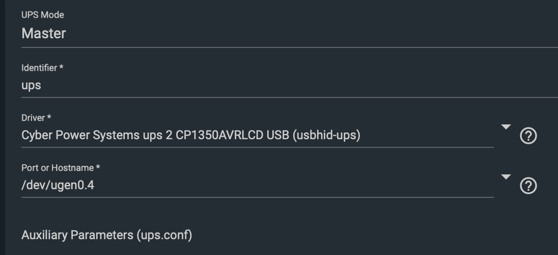

I'm having trouble getting my UPS service to run correctly, running under FreeNAS 11.3-U4.1 with a CyberPower (CST135XLU) UPS connected via USB. Basically, after configuring the UPS service in the GUI (using MASTER mode and the correct port: /dev/ugen0.4), saving configuration and starting the UPS service, going to the CLI (via SSH or Shell) I get the following errors when trying to determine the status of the UPS:

After reading through other threads and doing a bunch of detective work it seems to be an incorrect driver being used, I have determined that no matter what Driver option I try to set in the GUI and then save the change, it seems to always revert back to powerpanel (specifically: powerpanel$CPS1500AVR). I'm certain that the correct Driver should be usbhid-ups. I've attached a couple of screen shots of what I'm trying to select, vs. what the GUI always sets it back to.
The only way I've been able to get the UPS service to run is to disable it in the FreeNAS GUI, then manually edit the conf files in /etc/local/nut/ , with the most important change being the driver selection in ups.conf (changed from powerpanel to usbhid-ups), like so:

By way of further debugging, I've tried making other changes to the FreeNAS GUI UPS Service options (like the Shutdown Timer period, MASTER -> SLAVE mode, etc.) and all of those settings do seem to get properly reflected and survive a settings save and reboot (I think). Therefore, I don't think something got messed up with my system configuratino db. However, once again - whenever I change back to MASTER mode and try to select anything other than the powerpanel driver it has shown by default, it doesn't last even when I try to save again.
I appreciate any help in correcting my issue. Thank you for any tips or solution to my problem! Cheers.

This seems somewhat improved from how you described. I connected my CST135XLU tonight, and configured it in the GUI. I selected the CP1350AVRLCD, and I used usbconfig to figure out that my ups is plugged into /dev/ugen1.3.
