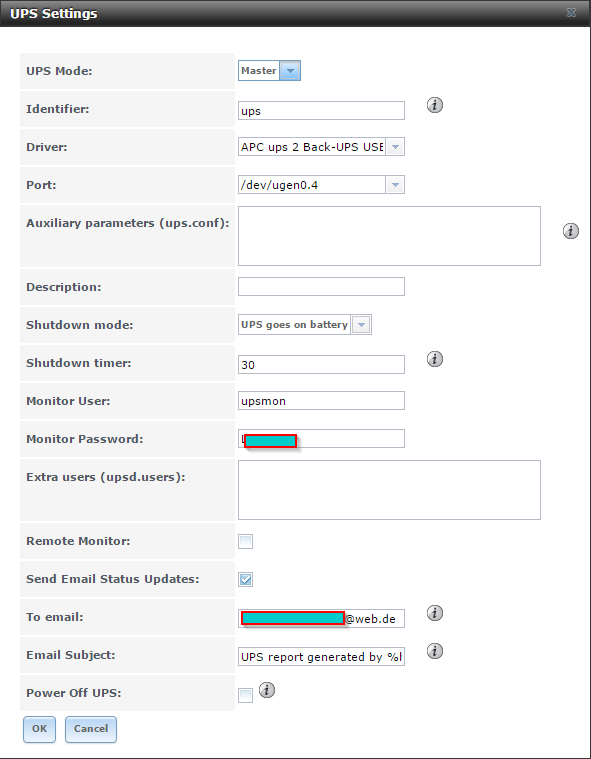

Now I've faced this multiple times and since the email signalling also does not work for ups (for every other error I do get an email though, any ideas why that might be?) this is preventing me from making this installation reliable :-( I attached a screenshot from my ups configuration.
Any ideas?
Thank you very much :smile:

Is it possible to simulate the "pull cable, plug in cable" procedure with a script that can be run every hour or so?
