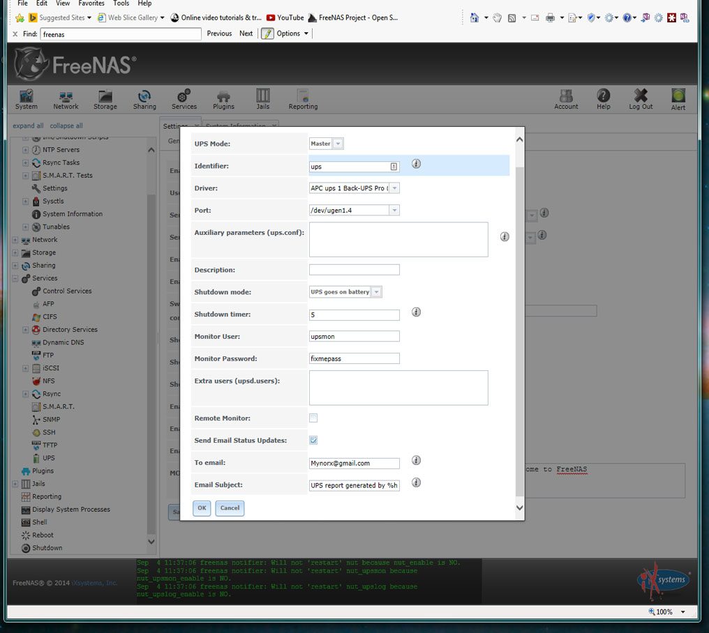

Heres the print screen
LOL you have to start it? I'm guessing its a command because I don't see a check box or drop down menu. Let me check that out
Go to services and turn UPS (or was it NUT?) on.
