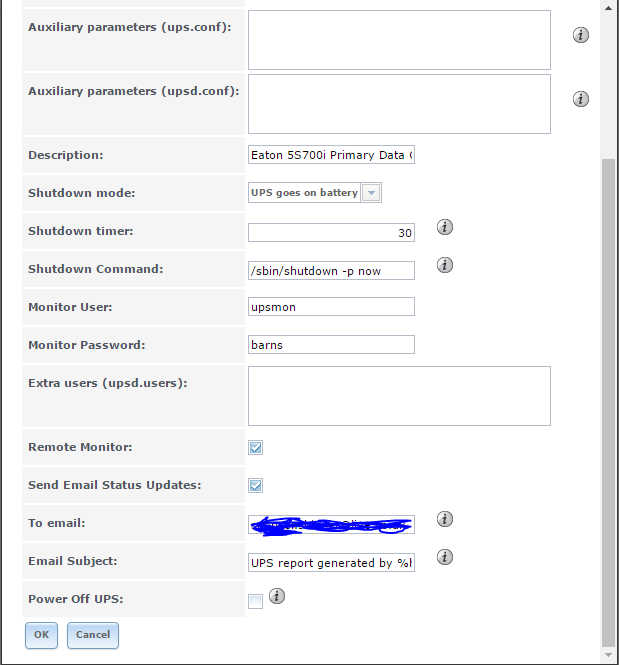

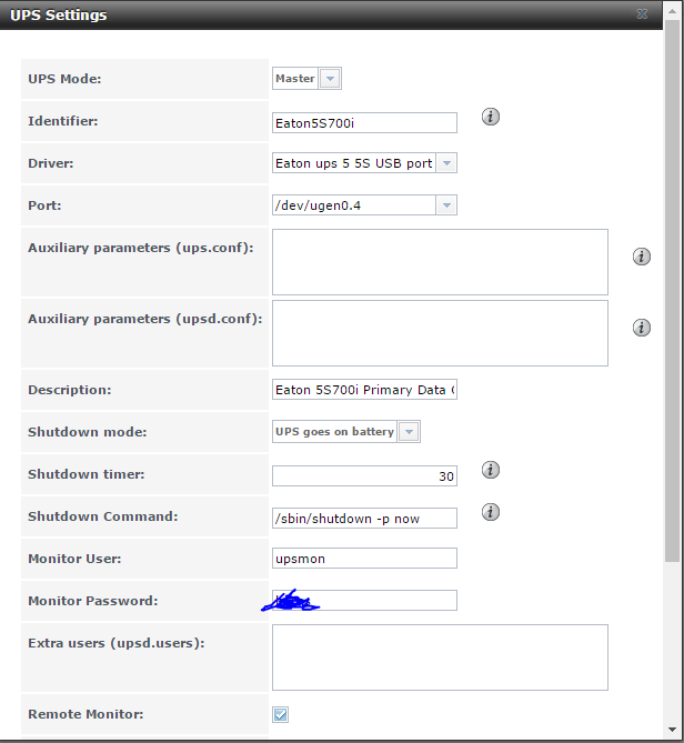

Here are the setting i have enabled -
View attachment 15729 View attachment 15730
Any ideas as to what this could be, cant be normal surely?
